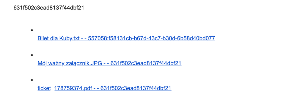

sure - clarifying :)
i've tried this code
{{varReporter}}
<ul>
{{#issue.attachment}}
{{#if(not(equals(author,varReporter)))}}
<li>
<a href="{{content}}">{{filename}} - {{varReporter}} - {{author}}</a>
</li>
</ul>and Mail I've received looked like this
so
this means (as far as i uderstand that this code wors preety much like this
{{varReporter}} - this works
<ul>
{{#if(not(equals(author,varReporter)))}} <<== here varReporter returns null
<li>
<a href="{{content}}">{{filename}} - {{varReporter}} - {{author}}</a> <<== here {{varReporter}} returns null
</li>
</ul>sorry - i don't know how to explain this other way;/
