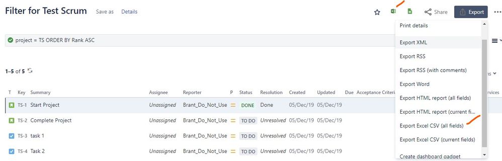

@pmn247 you can easily export to CSV / Excel using a filter.
https://support.atlassian.com/jira-software-cloud/docs/configure-filters/
