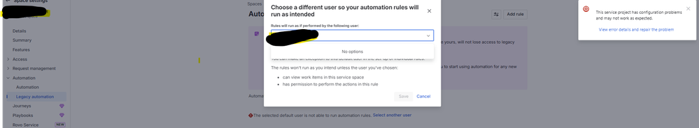

Hello everyone, I have an issue with one of my jsm espaces. When I opened it, I had an error like that:error_jsm.png
Some problems need your attention
The user to run automation rules is misconfigured
Automation rules run as a specific user. The user selected to run these rules no longer exists or does not have sufficient permissions anymore, so automation rules have stopped running.
Select another user
and when I tried to change this user to another I can't, I just saw no options, everything works in this space but I don't know why I have had this issue for 2 months

Hello @Diallo
Which permission did the previous user had when they were on the project?
Diallo
May 19, 2026
hello @Nikola Perisic , thanks for your feedback, i check the user access, i had to put user agent on his permission, it's ok now.
