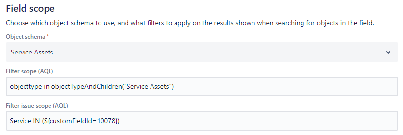

Hi unfortunately this is not working for me, here is what i tired based on your advice.

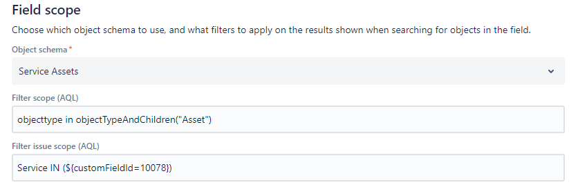

Also tried

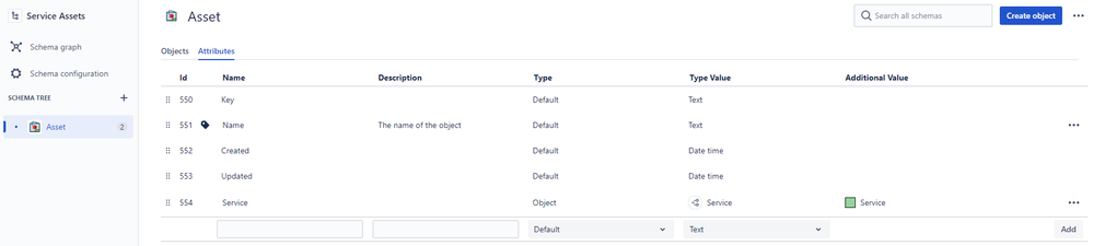

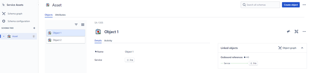

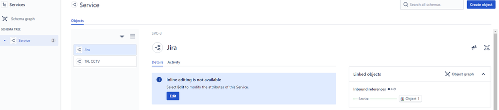

Hi Jeroen, that's fine as it's a test schema in preparation for migrating our old server based Asset database to cloud, I need to figure this out so we can complete our Server to cloud migration of JSM. unfortunately as you may be aware Assets on server does not transfer over and the custom fields available have gone from 2 (object and referenced object) to one "asset objects"
There is the schema for the services which can only contain services (i have made this visible to other databases so it's objects can be referenced)
Here is the dummy schema and the attributes I setup to test this process because as stated before I need it to work before I can migrate

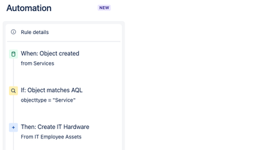

There is some workaround you could try and I'm just spitballing here, haven't tried it. In the Automation rules section of Jira Cloud you can trigger on Assets create / updated / deleted ... and the Services Objectschema is also selectable there.
You could create an ObjectType in your Assets schema containing the Services, then link from the asset to that ObjectType (this way the earlier described syntax would work). Then to keep the Services up-to-date you could create an automation rule:
  • Trigger object created / updated / deleted of the Opsgenie Services (in the built-in object schema
  • Condition filtering on Objecttype
  • Action: Do the appropriate action on your custom Services objects
Not sure if you'll get there entirely, but is your best shot at this point.
