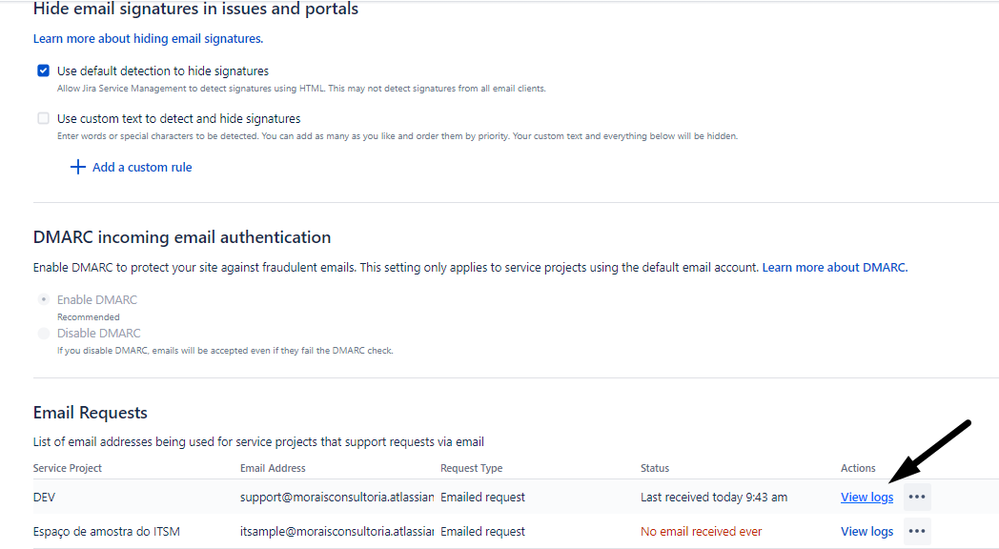

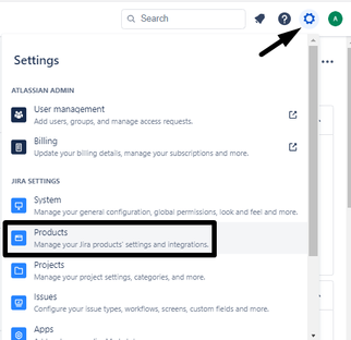

To better debug the problem take a look at the logs.
Gear Icon > Products > Email Requests

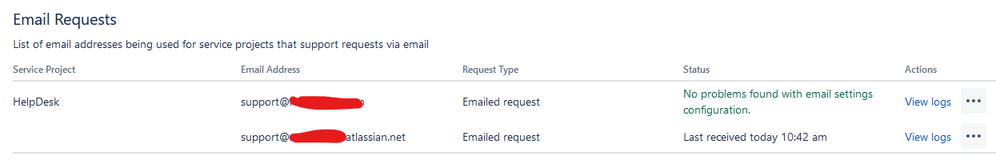

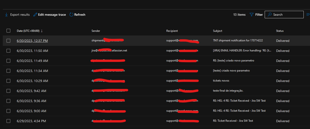

I saw one log from yesterday.
than I check if is right configurated
after that I was getting information on admin365 from recieved emails
all seams to be OK.
but I dont recieve more tickets.
When I sent messages to default atlassian.net mail it creates a ticket without problems.

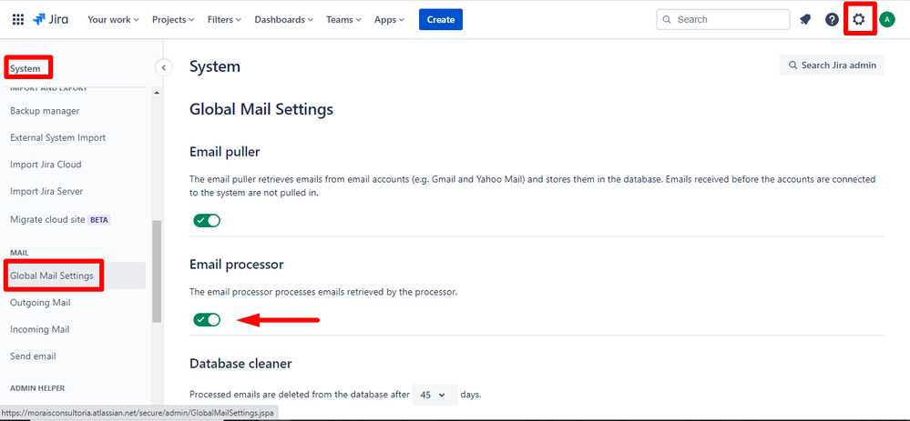

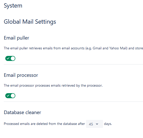

Go to Jira Settings > System > Global Email Settings and make sure the email processor is enabled. If not, enable and test sending an email to confirm a ticket will be created.

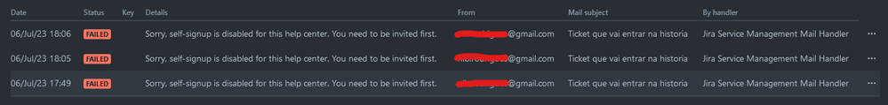

Now I have another problem, related to receiving emails in jira that are not being created tickets.
How can I solve it?

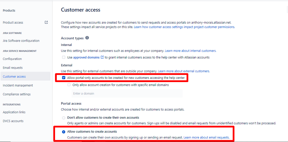

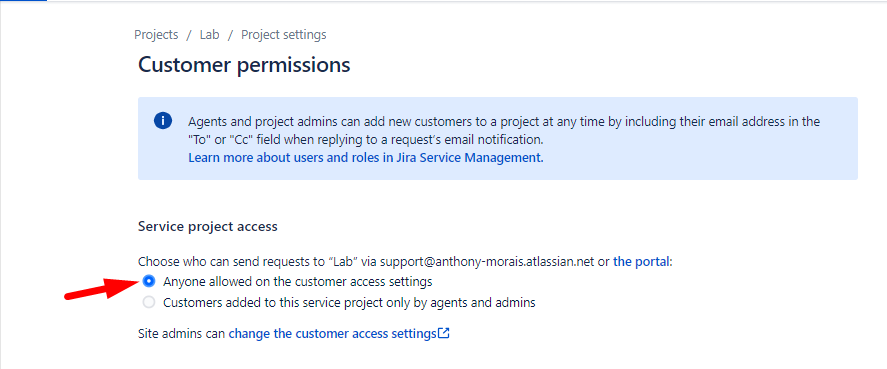

From the print you sent it seems to me to be client permission problems, try the steps below
Go to the address below and check the two boxes that are in red.
https://YOURSITE.atlassian.net/jira/settings/products/servicedesk/customer-access
Then go to Project settings > Customer permissions > Service project access and check "Anyone allowed on the customer access settings"

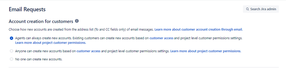

Go to https://YOURSITE.atlassian.net/jira/settings/products/jira-service-management-email-requests and also make sure that one of the two main options for creating an account for the customer is selected
