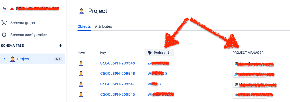

We have a simple scheme:
What I would like to do is that, upon selecting the project, a second field allows me to select only the project managers of the selected project.
Is it possible?
Thanks
