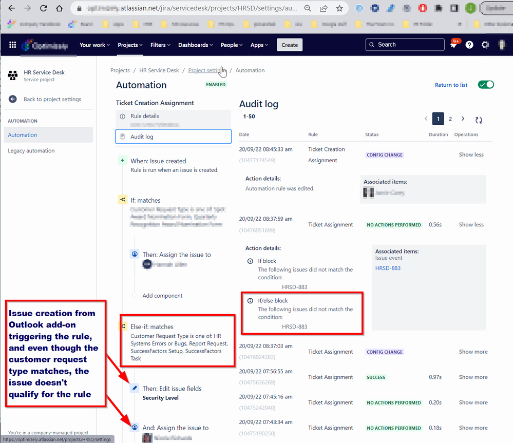

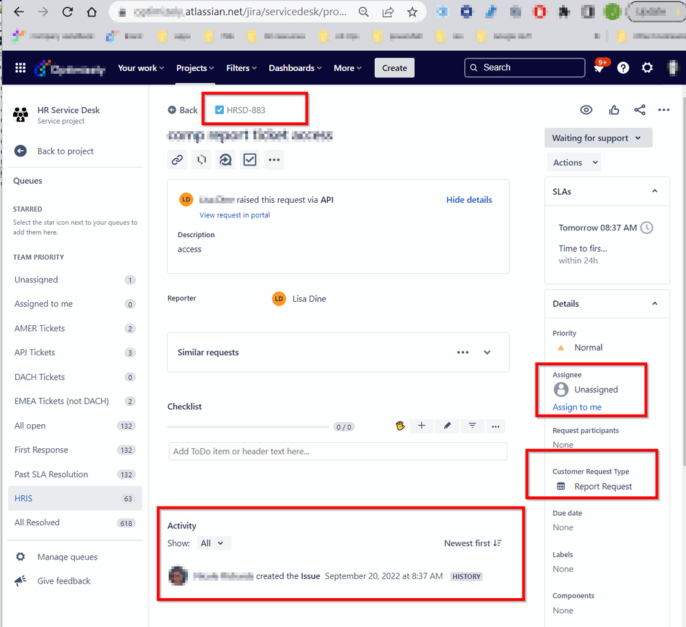

We have an automation rule which triggers on issue creation. When issues are created from the Outlook add-in, the issue is evaluated and sometimes the issue qualifies and sometimes it doesn't (even when it should).
The rule should should be qualifying the issues from Outlook add-in every time based on the customer request type value we set (which are auto-suggested when setting up the rule, so we know it's not a spelling error).
Images below show example of problem: rule shows customer request type is one of Report Request but issue did not qualify even though the issue's customer request type is Report Request.
2022-09-20 08_52_54-Automation - JIRA.png2022-09-20 08_51_45-[HRSD-883] comp report ticket access - JIRA.png

Thanks Pier-Olivier - that was my thought as well regarding updates *after* the issue creation, but the screenshot I provided shows all the issue history after the issue failed to qualify (just the single line where the issue is created).
Talking to Jira support, they say to re-fetch the issue history before the condition, but that seems really heavy on automation for something that *should* work. (The re-fetch can only be added before the first condition, so it would trigger on every issue created.)
Similarly, adding in any additional transitions creates the same load on automation rules when there's literally no other activity in the history of the issue that would account for the rule not triggering. It's odd.
