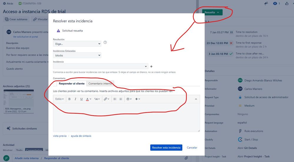

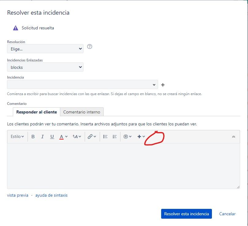

At the moment that I am going to close a ticket and I give him a resolution, he opens a box to fill in the information of what was done but I would like to attach evidence, is it possible to add that button?
If you can, how would the step by step be?

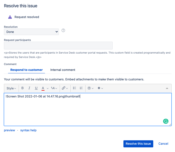

When resolving an issue, currently, the only way to add an attachment is by embedding it using markup.
!image.jpg|thumbnail!
The attachments must be added first to the ticket and then, use the option above to embed it on the comment.
With this said, before resolving the ticket you need to add the desired attachment as an internal comment and then click to resolve the issue and on the comment, you need to use what I mentioned above so the customer will be able to see the attachment in the customer portal.

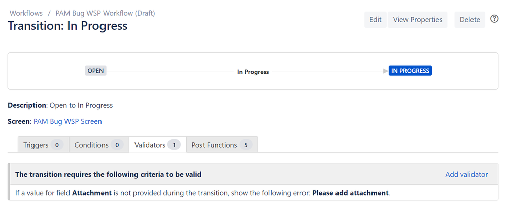

You can add a field required Validator to your transition to done/closed for the Attachment field. Also add Attachment to the screen that you apparently already have in place on the transition.

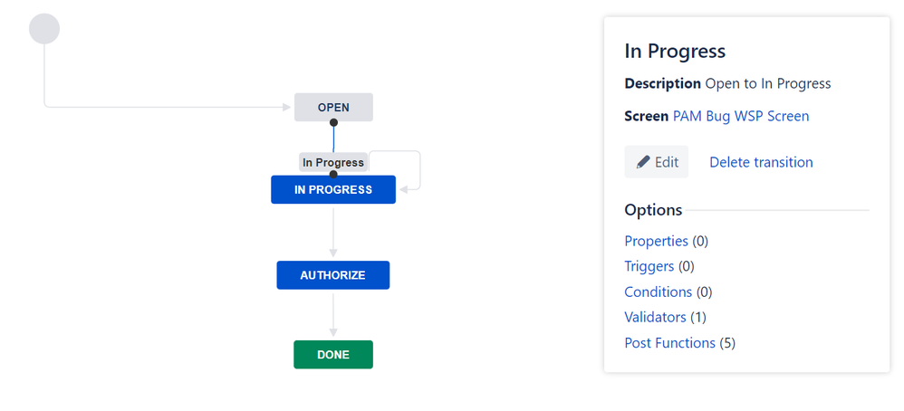

If yes, navigate to the workflow where you need to make the attachment field required and add the validator as shown below
Validator is as shown below

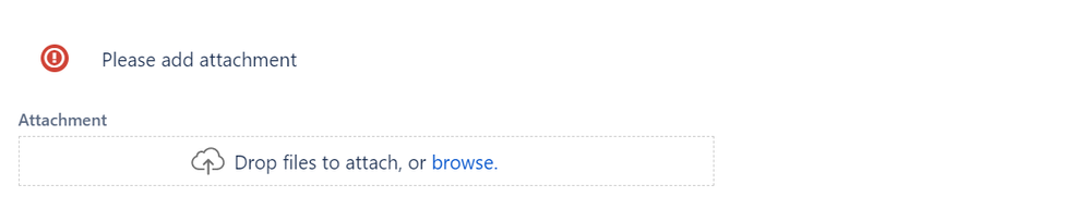

The result would look like this

I am doing that configuration but it does not show me the field to be able to attach files when the case is resolved.
You don't have a detailed step-by-step.
