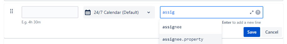

Saáry Ákos
September 28, 2022
When I want to make a new SLA, assignee.property is an option what jira suggests.
I'm not sure that's what Christine meant, but I'm also not sure that your answer apply to this. Maybe it is, but it's "property", and not "properties".
