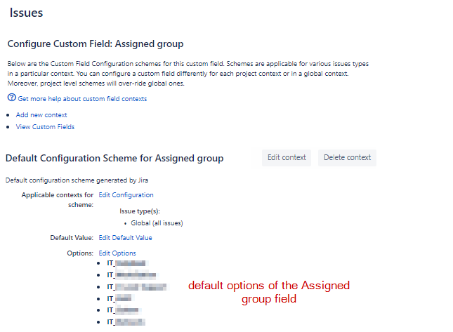

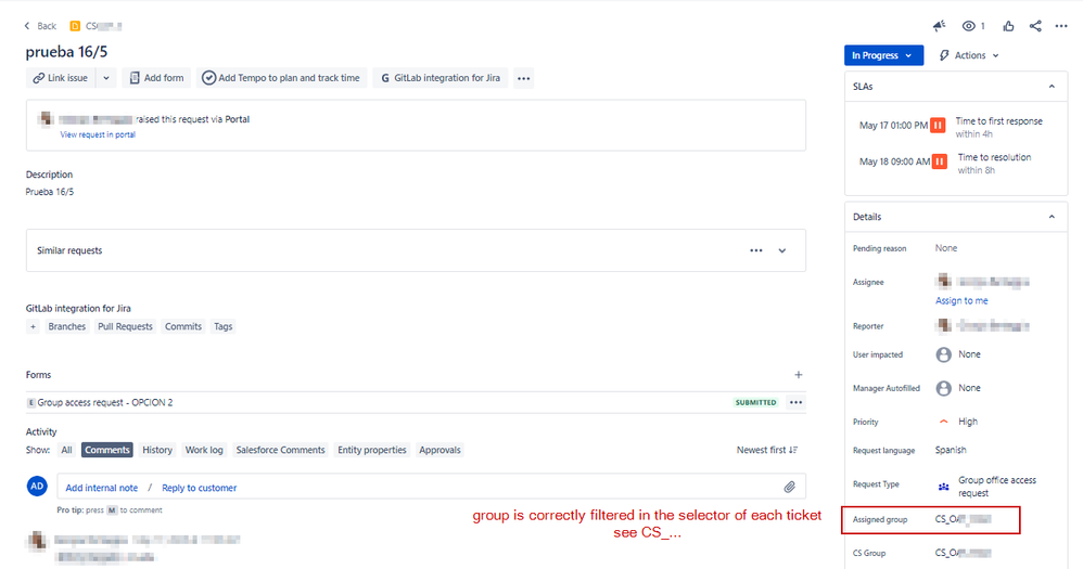

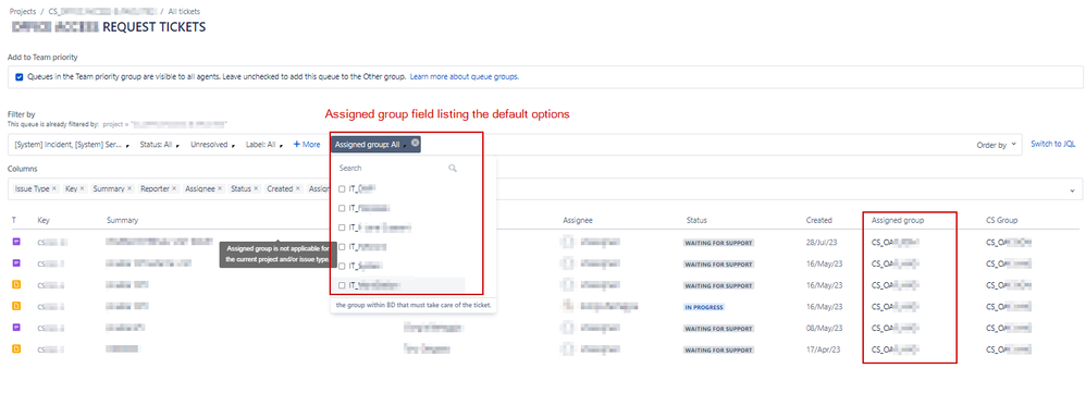

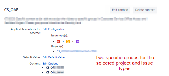

However, now doing the filter for the queue I see that although the group is correctly filtered in the selector of each ticket, (Picture 2) When it comes to including the field "assigned group" to filter the queues by groups, I get the groups that are set by default (Picture 3) not the specific ones indicated in the context for the project (Picture 1 and 4) and the types of incidents  I include some screenshots so that you can see what I mean. (I blur some areas to avoid sharing more information than necessary1.png2.png3.png4.png

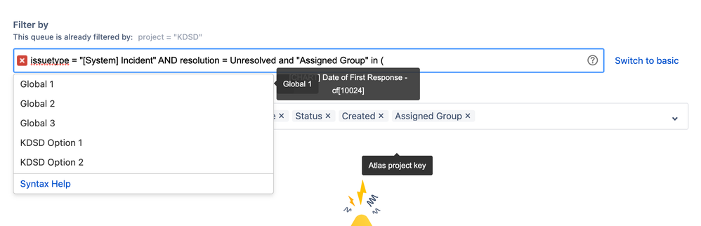

Hi @Andrea Dieguez ,
I did a test on my environment and i experience the same issue.
When you create a queue, and use the "Basic Search", it only lists the values of the global context. I think this is a bug in Jira.
You can bypass this issue by switching to JQL search. When you use "Assigned Group" in the JQL, it will list all possible values.
