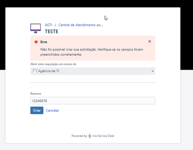

Hi
I just moved from cloud to server, and I can not create issues in the Service Desk portal. I can create it from the admin in the same project filling only the issue title.
It is working fine in cloud and no changes were made to fields or validation rules. I also checked the "create" transition in the flow as suggested in in https://community.atlassian.com/t5/Jira-Service-Desk-questions/Your-request-could-not-be-created-Please-check-the-fields-have/qaq-p/1218739
What else can I check?

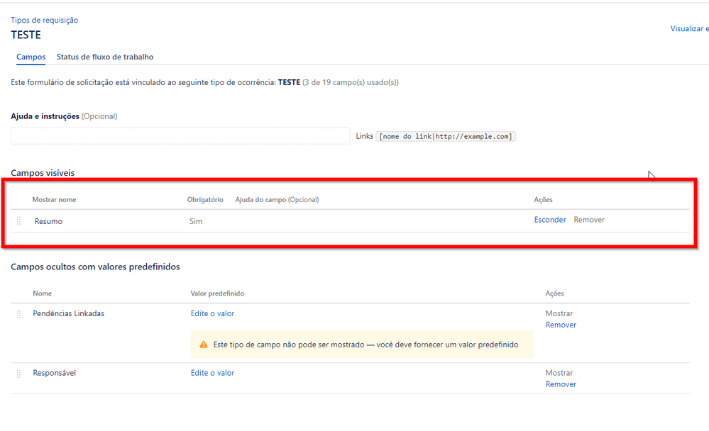

Hello @Suporte AGTI,
Thank you for reaching out to Community and for sharing the screenshots.
I see that you already created a new project, but as per the screenshot the field "Pendências linkadas" is hidden and no value was added to the field.
When a field is hidden on a request type form, it's necessary to add a value, otherwise, the error you are seeing will appear and the customer won't be able to create a ticket.
Please, add a default value to the field or remove it from the form.
If you have any other questions regarding this matter, please let us know.

Hi, thank you for your reply. Yes, I checked it. I even removed every field and left only the issue title, but the error still occur.
