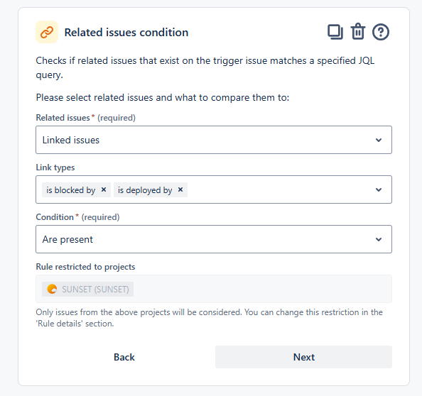

@Danilo Simic , have you tried the Related Issues Condition in an automation rule?
Considering some conditions/validators in workflow probably you will not have considering naturals resource, but if possible to bring this case for an automation rule you can compare this using a Related Issues Condition.
You can use this for example:
Let us know if you have questions
Hello @Fernando Eugênio da Silva
Thank you for the suggestions but this will not completely solve my problem. My automation is already setup to trigger for specific link types.
The problem is when that specific transition is used, users link the correct ticket but use the wrong link type so automation is not trigger. I am looking for a way to block this transition if the link type is not "causes".
@Danilo Simic , Got it!
Considering native resources in Jira this will not be possible to be done. Only using some add-on like Jira Misc Workflow Extensions, Script Runner or another else.
What I can say is to try to use a message field to be displayed in the screen remembering these users to use the correct link type.
