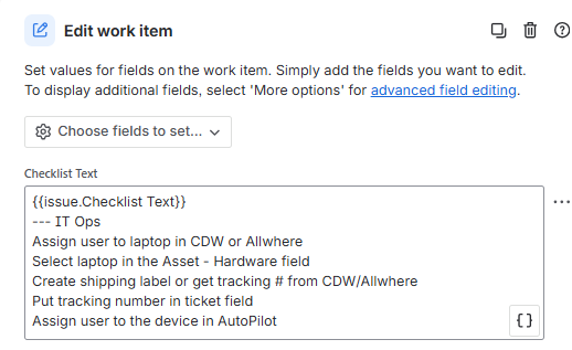

For checklists we use an add on called Checklists for Jira, that's by Herocoders I believe, where the checklist items can be set by the "Checklist Text" field. We already had this installed in our environment for other use cases so we utilized it, but I think without this checklist functionality we would probably go the sub-task route.
