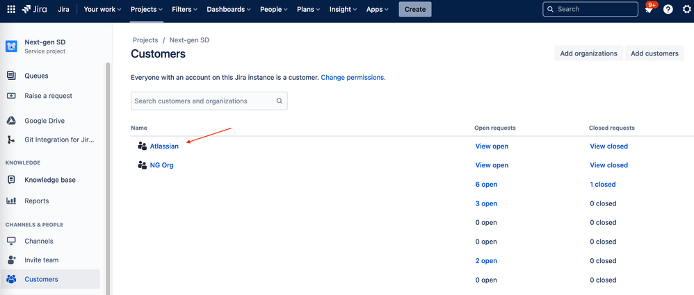

You mentioned on the question “I'm not getting notifications on requests created from people from my organization”.
Something that may prevent notifications from working correctly is being part of two roles at the same time, in this case, agent and customer.
So, you are a project lead who is an agent/admin on the project, but if you are added to an Organization and the ticket is shared with the Organization, Jira won’t know what type of notification to send to you, since you are an agent, but at the same time, you are also considered a customer if the ticket is shared with the organization.
Can you please confirm if the internal users that create tickets in this project are part of an Organization? Also, check if you are not listed there and if so, please, remove your account from there.
Please, take your time to test and let us know how it goes.

Martina Schusterová
June 18, 2021
It helped, thank you Angélica!
It didn't occur to me because I know I was amongst the customers of my organization while we were on server too and it didn't cause any issues. But I do admit the internal notification scheme was set up differently then with different admin. :)
