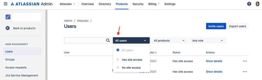

When this message appears, it can be related to the customer already being created on the ticket, but inactive or they already have permission to the project.
Can you please ask your site administrator to go to Cog icon > User management > Jira Service Management and check if the customer already has an account.
Also, ask them to check under Users to make sure that no account exists with the same email address and is inactive.
Checking the details of your site, there is an inactive user that matches with the email address you mentioned, so if that’s the same you are trying to invite, then it’s necessary to delete the account, so you can invite again or let them active and remove the groups, so they won’t count towards a license.
