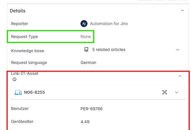

Why are the fields in the work item all on the right?
Antonia
August 1, 2025
I have checked the request type, work item and the screen, but whenever I set fields there, they end up on the right-hand side, but they should just end up under Description.

Sebastian Krzewiński
August 1, 2025
Hi @Antonia
In Cloud it is not working like you described, especially in JSM. All fields (excluding Description and summary) will be always displayed on right panel. Fields that will be filled by customer (appear on request form) will display under description.

Antonia
August 1, 2025
Hi @Sebastian Krzewiński
i think thats not true, because  I have other work item, where its working:

Marc - Devoteam
August 1, 2025
Hi @Antonia
The only thing you can try is to recreate/duplicate the request type and see what the result is.
If it works there is something wrong with the request type, I would raise that to Atlassian Support, and try to have a session with them to show this.
This is nit normal and erratic behaviour
Antonia
August 1, 2025
Hi @Marc - Devoteam
thank you. With the duplicate it works! But I can't hide it from the portal, thats strange. I will raise a ticket.
Jovânio Junior
August 1, 2025
hello, can you confirm this?
Make sure you are on a company-managed project, as behavior changes on team-managed projects.
Remove and add the field back to the layout — sometimes this forces Jira to correctly reload the position.
Test in incognito mode to ensure it is not browser cache.
Antonia
August 1, 2025
Hi,
thank you for your help.
So I tried to remove the fields and add them back, but it doesn't work.
I'm not sure, what the project is, if company- or team-managed, but I think coompany-managed.
It acutally stood here.
