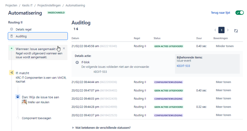

In our sandbox this automation rule works, in our production environment it doesn't. What could be the explanation for this?
The only difference is that in our sandbox environment the issue is made with the new Forms, in our production environment we use the Proforma add-on. But I don't think that should make any difference.

Try re-fetching the issue's data before that If statement. From the looks of it, the rule is triggered before any value is entered on that field. That's why no action is taken. Since proforma on the prod level is an app, most likely it could take place AFTER the rule has ran. :/

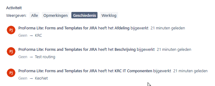

"One difference with respect to design and function is that the add-on actions(such as copying field, attaching form, etc) all happen after the Jira create action. While with the native forms it happens bundled together with the Jira to create action."
So re-fetch data should be the solution, the support employee indicated to add the re-fetch action 2-3 times. Hope this works. Otherwise we'll just need to migrate to the native Forms instead of the add-on.

At first glance that should be correct and triggering (especially if you mention it works on PROD and not in the sandbox).
Could it be that the value on the "KRC IT Componenten" field was not entered until after the creation of the issue?

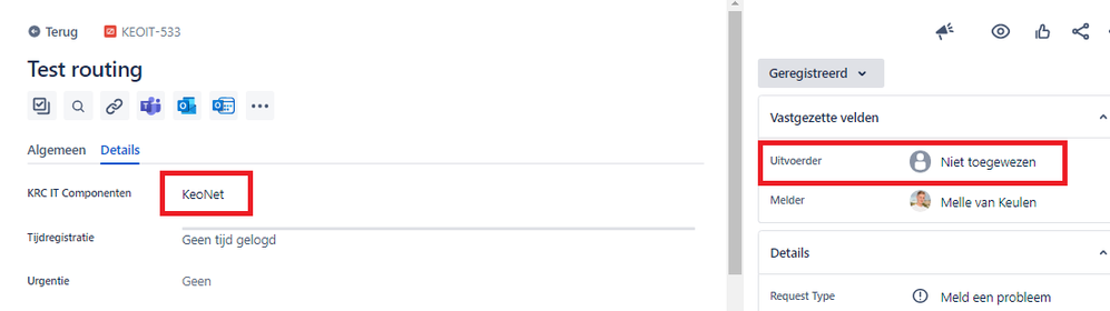

It works in the sandbox and doesn't work on PROD. THe value KRC IT Componenten is entered when filling in the form, so not after. This is also seen in the history of the issue.

Oh I do believe that Automation with the integrated version is still partially under development so that might be it.
Also it depends on how Proforma is filling it in, is it thru some internal automation which is "after" the creation or is it part of the creation. That's something we cannot be sure about right now.
