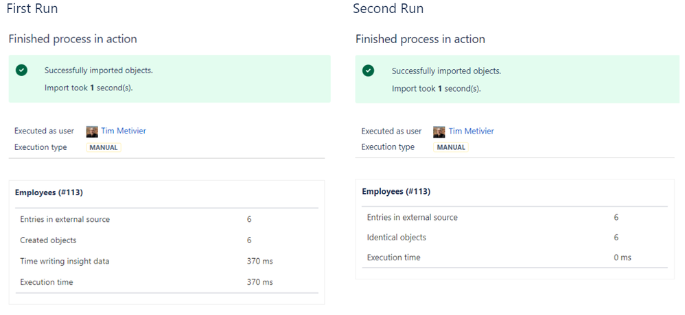

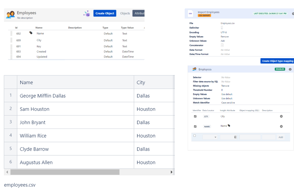

City attribute as Default Text type
Using the following configurations and importing the employees.csv, I can execute the import configuration a second time with the exact same data and file.
These screen shots show the first and the second imports, and as expected, there are 6 identical objects on the second import.

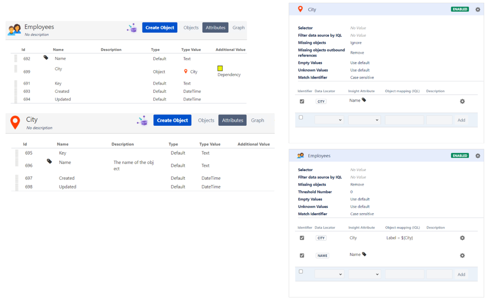

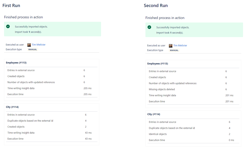

City attribute as Object type
In this scenario the City object type is introduced, and the Employees City attribute is changed to object type City.
Now, after importing the objects initially, a second run with the exact same data and file causes all objects to be considered "missing". They are deleted and new issues are created.
This creates a particular problem when using the Update Missing Objects approach as all objects are considered missing, new objects created, and the existing objects have the configured field updated.
I'm hoping someone can explain why objects with object reference attributes always are considered missing on import and if there is a way to prevent it.

Hi
I tried to recreate your problem and it seems to behave differently on DC vs. Cloud. In DC it works as expected, but on Cloud I get the same problem with referenced attributes.
In you case I would say you have two options:
  • Add an extra text attribute "City text" which you use as Identifier instead of the Object attribute. Like this:citymapping.png
  • Only use User attribute as Identifier. The Identifiers will alone or together set a unique combination to find the correct existing object in the import. In your case you should probably use a username, userid or email as a single unique identifier.
