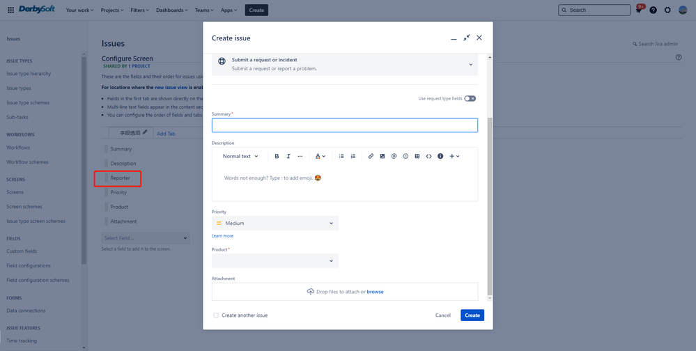

I configured the "Reporter field" of the Issue Type but it didn't show up when I created the issue as below. Could someone help me out?
Also, I would like to disable/remove the Issue Type selection as circled red in the screenshot below like other projects in my company. But I'm not sure how to do that.

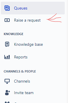

When raising a request in Jira service management please use the "Raise a request" link in the left hand menu and not the create button on the top.  This is the proper way to create a service management issue.    This will also provide a raise on behalf of option if you are an agent on the service management project.

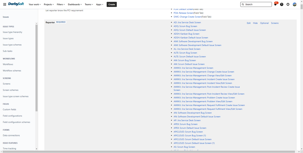

@Brant Schroeder Yes, the field is added to the create screen. Please see my screenshot below.
As for the second screenshot, the screen that is used by creating this issue type is ensured to be included in this required "Reporter" field.

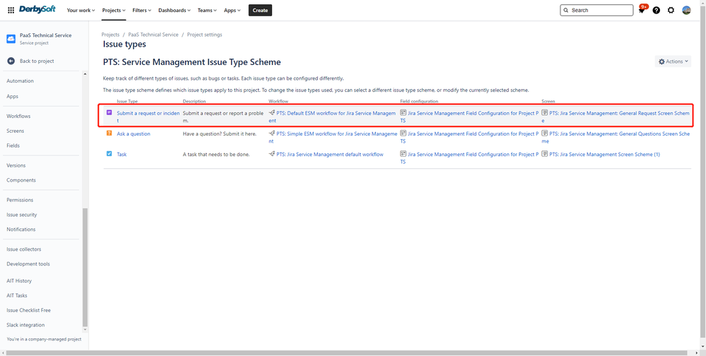

What issue type is the request type?
Can you share a image of the issue scheme?
Vincent Zhou
May 12, 2023
@Brant Schroeder
Is this what you'd like to see?

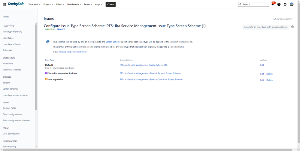

@Vincent Zhou Can you share the PTS: Jira Service Managment: General...... Screen scheme?
Vincent Zhou
May 25, 2023
@Brant Schroeder sorry for the late feedback. Please see attached.企业微信截图_20230525171211.png

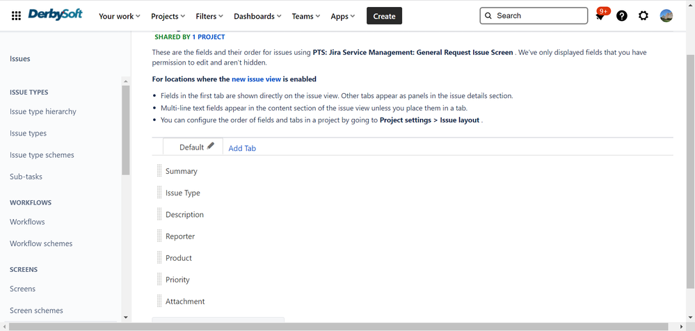

@Vincent Zhou that is the screen can you share the screen scheme?
Vincent Zhou
May 25, 2023
