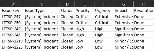

Create your project in the new instance with the same Key.
When importing by CSV, ensure you have an Issue Key column with values in issue key format like so:
And then they'll upload with the same key.

I have done the exact process I outlined above and it worked.  We deactivated an old instance and brought it in under our new instance as an new project. We have retained the same key for every ticket so that if staff need to refer back to an old ticket and they have the number it matches to the new instance. In this situation we were moving to a new project with no tickets in it so none of the issue keys existed in the new project.
However, yes I agree if they are moving to an existing project that is already in use with multiple tickets and the key already exists it will update the existing ticket. In which case, it is better to have a custom field, move the previous ticket number value to that column in the CSV and then Issue Key will be the value from the new instance that you want to update.

There is no order in my CSV upload file that I did for the key. It jumps all over the place., there's gaps in the numbering because of deleted issues etc., Every issue key has been uploaded with the key I listed in the CSV.
