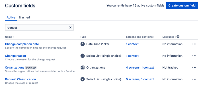

I would like to be able to get a list of all the custom fields I have specified and all the available options and how exactly i have to write them to be able to write SLA conditions. I can view all fields but there is no way to see in the admin/custom fields section what options are attached to each field.

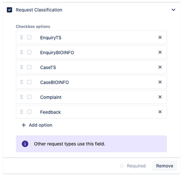

The Custom Field is called "Request Classification" and is a checkbox field type.
The options I have to select from are:
EnquiryTS, EnquiryBIOINFO, CaseTS, CaseBIOINFO, Complaint, Feedback.

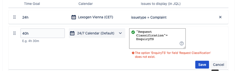

If I try to enter the custom field in the SLA I get autocomplete options for "Request Classification" and all the options I have for this custom field. However, none of my queries are being accepted. I get a message that the option does not exist, or the operator is not valid.
example:
"Request Classification" = "EnquiryTS"  --> "The option "EnquiryTS" for Field Request Classification does not exist.

I just tried it for a next-gen Service Management project with a new custom  field "Request Classification" of type "Checkbox" but it works just fine:
Please note that for a custom field in a next-gen project you will not be able to see it from custom fields overview - because they just "live" in the created next-gen project.

You are right, the options can be shown in "request types" - as your screenshot shows for "Request classification" (the last one).

Your Query seems simple. What could help with your Query is to write it in "Basic" under Advanced Issue Search. Once you select your options switch to basic and copy and paste the JQL into your SLA configuration. This may help you see what you are missing in the JQL. Just an idea.
