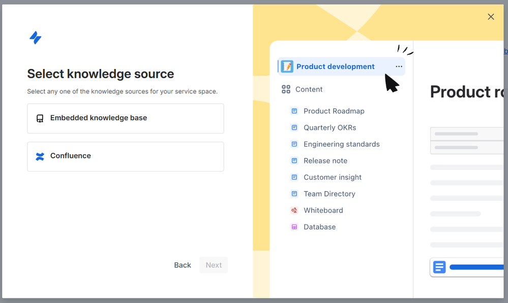

I click Add Knowledge in a JSM project settings and it shows me this:
According to this article:
https://support.atlassian.com/jira-service-management-cloud/docs/add-knowledge-from-microsoft-sharepoint-to-your-project/
There should be an option for SharePoint?
My cloud site is on the continuous track for updates. JSM is Premium (still in trial period). Rovo is enabled.
3 votes
Andrea Robbins
May 6, 2026
You have to be sure that it is added as a connector to Rovo at the organization level first. An organization admin has to do this for you. This is based on the information mentioned here:

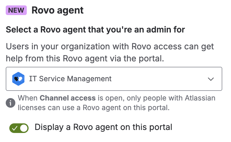

However, if I were you, I would do the above, but I would add the Service Agent to your portal instead. This is because it can use Sharepoint, Confluence, and many other resources this way. The method you shared in the link limits you to choosing only one source as quoted from the documentation:
At a given time, you can link spaces from only one knowledge source per space. To link spaces from any other knowledge source, you’ll first need to unlink the folders you’ve linked, and then continue adding your choice of source.
Andrea Robbins
May 6, 2026
