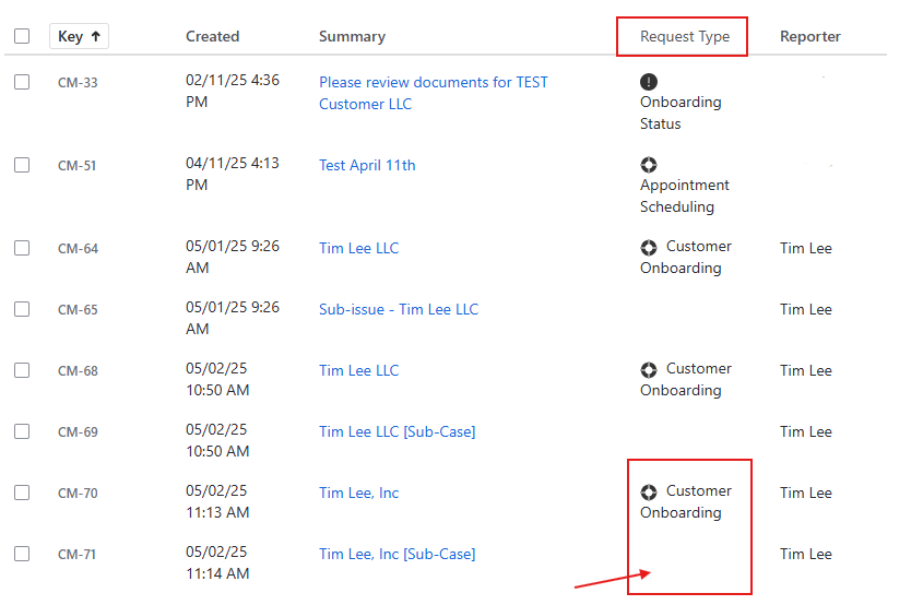

I have set an automation trigger to clone an issue when certain conditions are met. However, the clone does not inherit the "Request Type" from the original issue. So in my queue, that column is blank. Is it possible to inherit the Request Type when cloning an issue?

Automation for Jira doesn't automatically copy the request type when clonning a ticket, however you can make that edit in another action in the same automaton. This article shows you how you can set the request type for the clone ticket.
From what you described, I believe you will need to create different if/else blocks for each request type on your project.

This worked perfectly. Thank you!

What you are seeing is expected: Jira Automation’s built-in ā€œClone issueā€ action leaves the Request Type blank. To keep the Request Type automatically, you can use Deep Clone for Jira instead of the default clone.

In your automation rule, you will need to EDIT the issue again to populate the cloned issue.  Internally, the clone issue process is treated as issue creation not the same as issue creation via the portal UI where "Request Type" is invoked.
