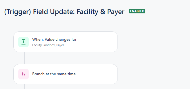

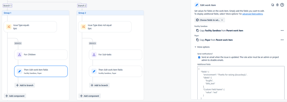

Hi, I do not have any experience with using JSON as a FYI! We created two custom cascading fields to replace our custom short text fields (Facility Sandbox & Payer). With that though we needed to update our automation rules that involved those two short text fields, but the only way to use cascading fields in an automation is using JSON, at least that what rules said.
Can someone help me create that JSON coding to add to the 'More Options' section of the automation? I grabbed the custom field IDs of the two new cascading fields to get started..
  • customfield_12256 (R&D Facility)
  • customfield_12248 (R&D Payer)Screenshot 2025-07-01 093814.pngScreenshot 2025-07-01 093833.png

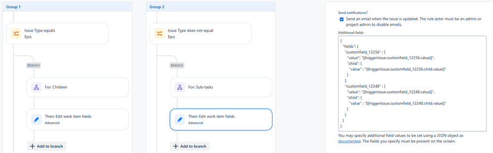

So each group is split for:
1. Each Epic and its Children Work Types (Issue Type equals Epic)
2. Each Child Work Types and its sub-tasks (Issue Type does not equal Epic)
[Side note, originally I had this all under one since I wanted any change to the Epic would update the corresponding to all Children including the sub-tasks, but it wouldn't work so I split it up like so. ]

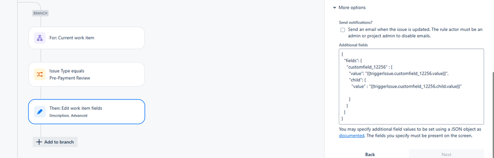

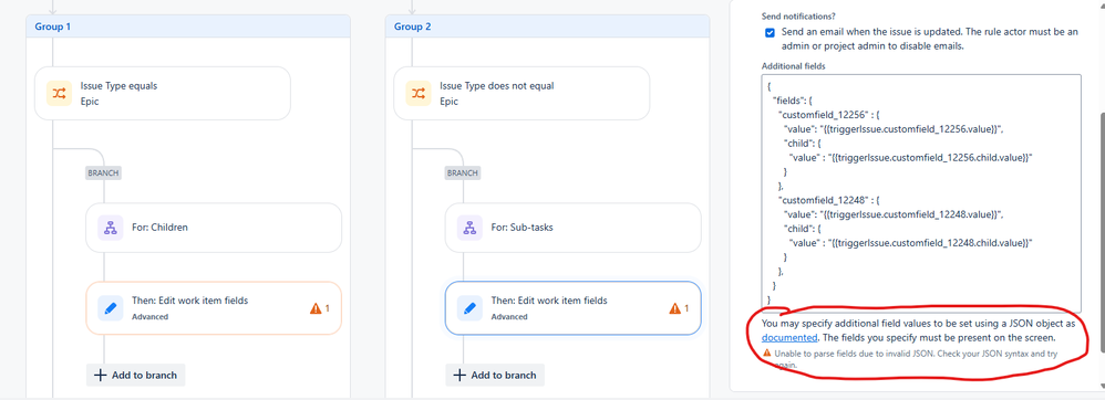

I tried but I am getting an error message? I am not entirely certain how JSON works but this is what I updated per your code above: Screenshot 2025-07-02 113755.pngScreenshot 2025-07-02 113814.png
Like • # people like this
Bill Sheboy
July 2, 2025
Thanks for the clarification, @Mireya Cintora on the issue types.  And, I had a stray trailing comma in my example which is breaking the JSON.  Please remove the final one after the customfield_12248 section.  I updated my earlier post to reflect both of those changes.

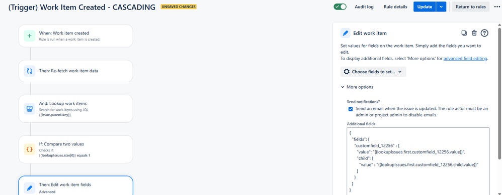

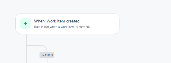

If I have another question related to cascading fields, can i ask here or create a new one? The original question I posted related to the trigger being "When: Value changes for," this time around when the trigger is "Work Item Created" I want any work item that has a parent work item, to copy over the field to its children work items.  I used the same logic that helped me solve the original issue but it did not work. See below:

This other case is different, and reveals there are other scenarios to handle.  (More on that in a moment...)  Your original scenario was:
GIVEN a parent work item with child work items
WHEN field <X> or <Y> change in the parent
THEN copy the field values to the children
Your new one is:
GIVEN a parent work item with fields <X> and <Y>
WHEN a child work item is created with the parent assigned
THEN copy those fields from the parent
For this one, branching is not used / needed, but we do need to get the parent's data using the Lookup Work Items action (because the fields are not in the dropdown list of the action).  Perhaps like this:
  • trigger: Work Item Created
  • action: Re-fetch Work Item Data (This action is important to mitigate a timing defect with this trigger.)
  • action: Lookup Work Items, with JQL of
    • key = {{issue.parent.key}}
  • smart values condition: To check the parent was found
    • first value: {{lookupIssues.size|0}}
    • condition: equals
    • second value: 1
  • action: Edit Work Item fields, this time getting the data from the lookup results
"fields": {
"customfield_12256" : {
"value": "{{lookupIssues.first.customfield_12256.value}}",
"child": {
"value" : "{{lookupIssues.first.customfield_12256.child.value}}"
Please note well: I only included the one field you show in your example.

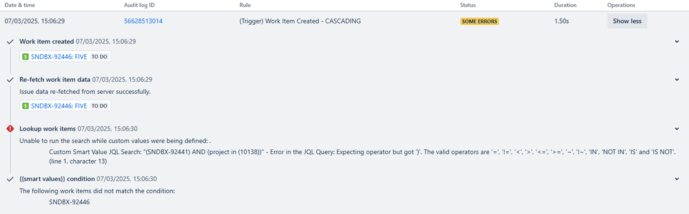

Ok so i created a new automation to try it on a small scale but it reported some errors: Screenshot 2025-07-03 150924.pngScreenshot 2025-07-03 151038.png

The JQL for your Lookup Work Items action is incorrect and does not match the earlier suggestion.  Please use this and then re-test:
And, that list of other cases were not questions: they are other possible cases to cover if you want them with additional rules.  Given the number of rules you may want, I recommend working with your Jira Site Admin to help implement them as variations of the one I suggested.

Mireya Cintora
July 7, 2025
Omg thank you! For whatever reason I did not think I needed the "key" part. It works perfectly now thank you!
