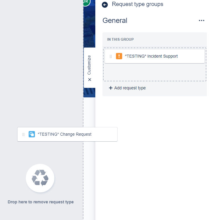

When attempting to hide a request type in a request type group from the customer facing portal by clicking customize and dragging and dropping it, the request type doesn't get removed and goes back to where it was. I tested this same process in a new project where I created a new request type group with multiple request types and it works on the test portal side.
From what I can tell I don't see any setting differences between the two projects (production and test) aside from the amount of groups, request types, and automations.

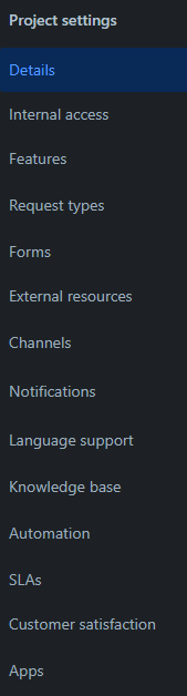

According to that, the it's the type of project which it mentions is called "team-managed (formerly known as next-gen)" which applies only to cloud platforms. I'll attach a picture of an example of what it looks like (although it's since been updated to drag and drop now instead of the "x" displayed in the KB) and the options for my project settings too. On the test project, the process works fine but just not on the production side which is confusing...
Hope that helps a little more.

Yes, they are both under the same cloud instance and it'll work fine in our test project but not production for some reason. For the historical part, in our production environment, we a have a request type that's for internal use and uses an automation to generate tickets. Since it's currently on our customer portal and can be a cause of confusion, we wanted to hide it. I reproduced that setup in our test project and tested it there to make sure the automation could still use the hidden request type to generate tickets. That worked great. I went to production and then it didn't work great. When I drag and drop it, it snaps back to the right into the group as if you dropped it anywhere outside of that grey "drop here" area.
