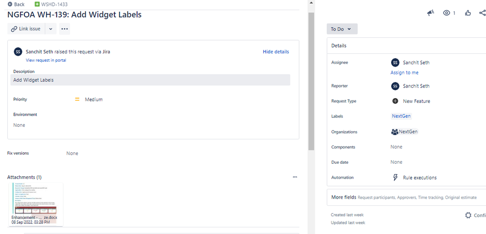

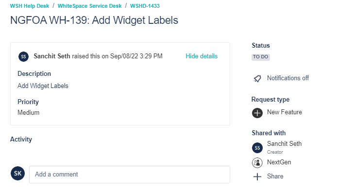

As we have created couple of tickets is one of service desk project and added couple of attachments in that while creating the tickets. But when we went back to customer portal it is not visible at that end since we can see those attachments at agent level view.
In request type we haven't missed attachment field but it still it not showing at the customer portal. Hope this could be resolved as soon as possible.

Actually what happened is, the ticket has to be created by customer but due to some issues he cant create a ticket and our agent has created a ticket and reporter is added as himself, request type added and also shared with the customer related organization by which the customer can also be able to view the ticket and updates on it. But the attachments added at the time of creation by agent using the "Create" button from the top were not showing in the customer portal even the reporter agent who created it himself it is can't see those attachments. Please check the below attachments for reference.image.pngimage.png
