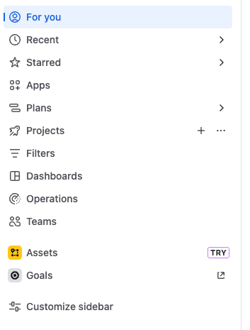

Hello @Murat Seven
thanks for your explanaition - but unfortunately I am not able to find the menu entry board:
Where can I find this entry?
Kind regards
Michael
Murat Seven
May 8, 2025
Hi @Michael Ruhdorfer ,
From the top navigation at the top of the page, select the search field (or press /) and select Go to all: Boards.
I’ve attached a screenshot of this process below;Screenshot 2025-05-09 at 9.33.15 AM.png

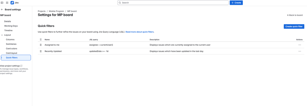

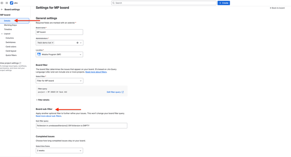

thanks for the quick answer. That helps a lot. But one more questions, can I a dd some more filter to the kanbanboard base on customer fields?
kind regards
Murat Seven
May 9, 2025
you're welcome :)
You can add filters to your Kanban board using JQL to refine the issues displayed based on customer fields. Here's how you can do it:
  1. Create a Sub-filter:
    • Go to your board and select More in the top right corner.
    • Choose Configure board.
    • Under the Filter section, find Kanban board sub-filter.
    • Select Add sub-filter and use JQL to create a filter based on your customer field.
  1. Use Quick Filters:
    • Quick filters allow you to switch between different views on your board.
    • Go to your board, select More > Configure board.
    • Select the Quick Filters tab.
    • Add a new quick filter by entering a name and a JQL query that includes your customer field
