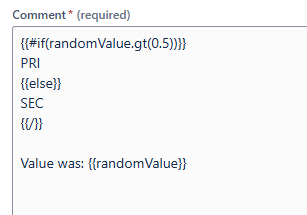

- Add an action Set Variable and set the variable  with {{RANDOM()}}
- add another action and use conditional logic as below
{{#if(randomValue.gt(0.5))}}
PRI
{{else}}
SEC

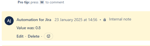

I've played about with this for a bit and fixed the value of randomValue to 0.8, but the output seems to be empty:
The audit log suggests the operation was a success

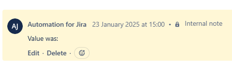

Even worse, if i commit  {{RANDOM()}} to the smartvalue it also returns empty:Screenshot 2025-01-23 150108.png
