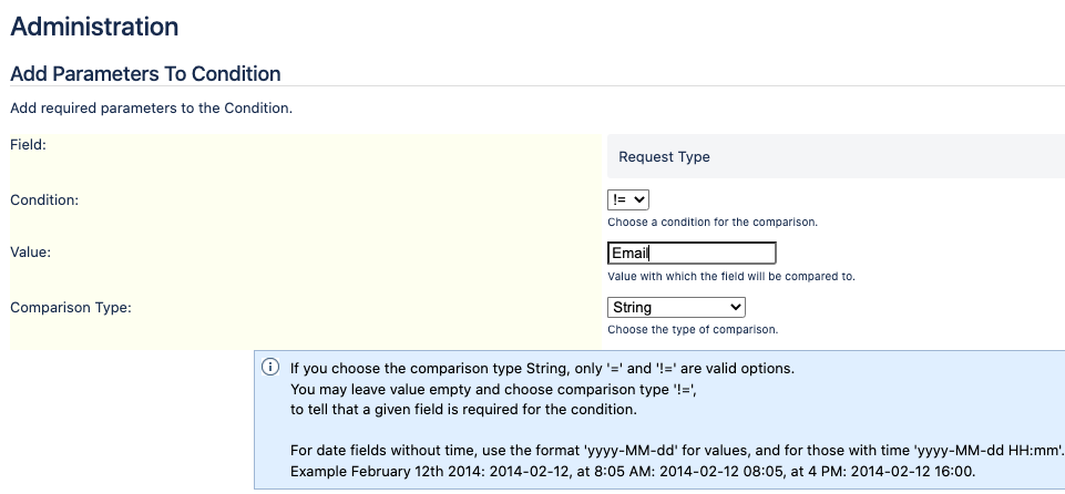

Hi @Simon Bell and welcome to the community.  Rather than a validator, I would recommend a condition on your transition from triage.  This would accomplish the same thing without having to figure out regex.  Here's how I configured in a test environment:
This would not show the transition availability in the status until they change the request type.

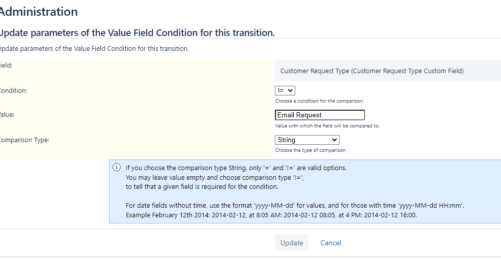

Hi @Mark Segall and thanks - yes I'm new around here. Thanks also for your advice - I've tried the above as per the image below but it's still allowing me to move tickets on, when the Request Type = Email Request.
I have double checked the spelling of the Value matches the Request Type exactly I.e. Email Request, that the workflow is published and that the condition is applied to the correct transition - any thoughts?2022_02_11_Condition.PNG
Mark Segall
February 11, 2022
Perhaps try quotes around Email Request?
"Email Request"
If that doesn't work, I can try setting something up in my test environment later today.
Simon Bell
February 11, 2022
Hi @Mark Segall no joy I'm afraid = I tried with both "Email Request" and 'Email Request'. I'm logging off now until 08:30 GMT - it would be great if you have a chance to try it out at your end, thanks.
