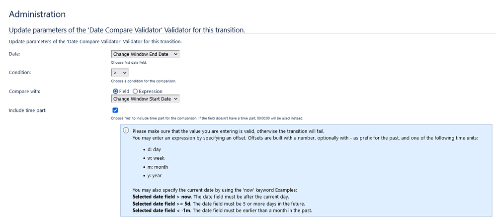

You can definitely add the Date Compare Validator to the workflow Create issue transition. Here is how we did it: Screenshot 2023-05-23 at 21-43-18 Update Workflow Transition 'Date Compare Validator' Validator - Jira.png
