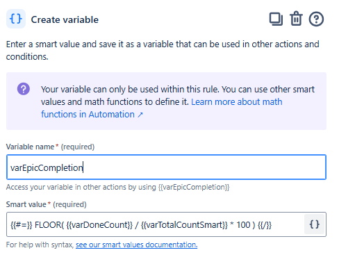

 the varEpicCompletion create

it seems to be working, I will keep an eye on it.
