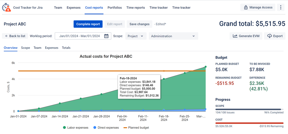

As mentioned above, you can use Jira automation. Unfortunately, Jira is quite limited with this kind of math calculations. If you are ok with 3rd-party tools, I can recommend a project cost management app developed by my team.
Time and Cost Tracker automatically multiplies worklogs (hours) by the hourly rates to calculate the total labor expenses for each task/user, and sum these to get the overall labor costs.
Moreover, you can create reports and add expenses to manage project budget in general.
