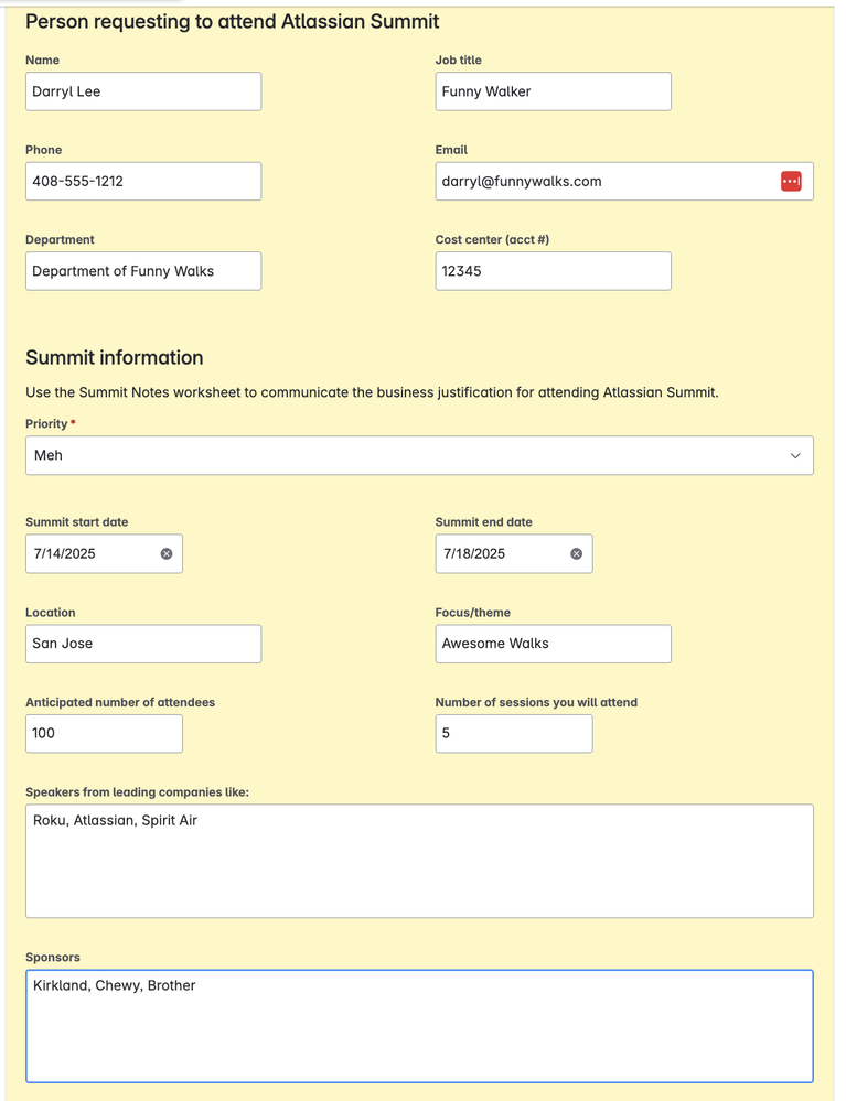

What my form looks like:Screenshot 2025-07-09 at 10.23.40 PM.png
Like John Funk likes this

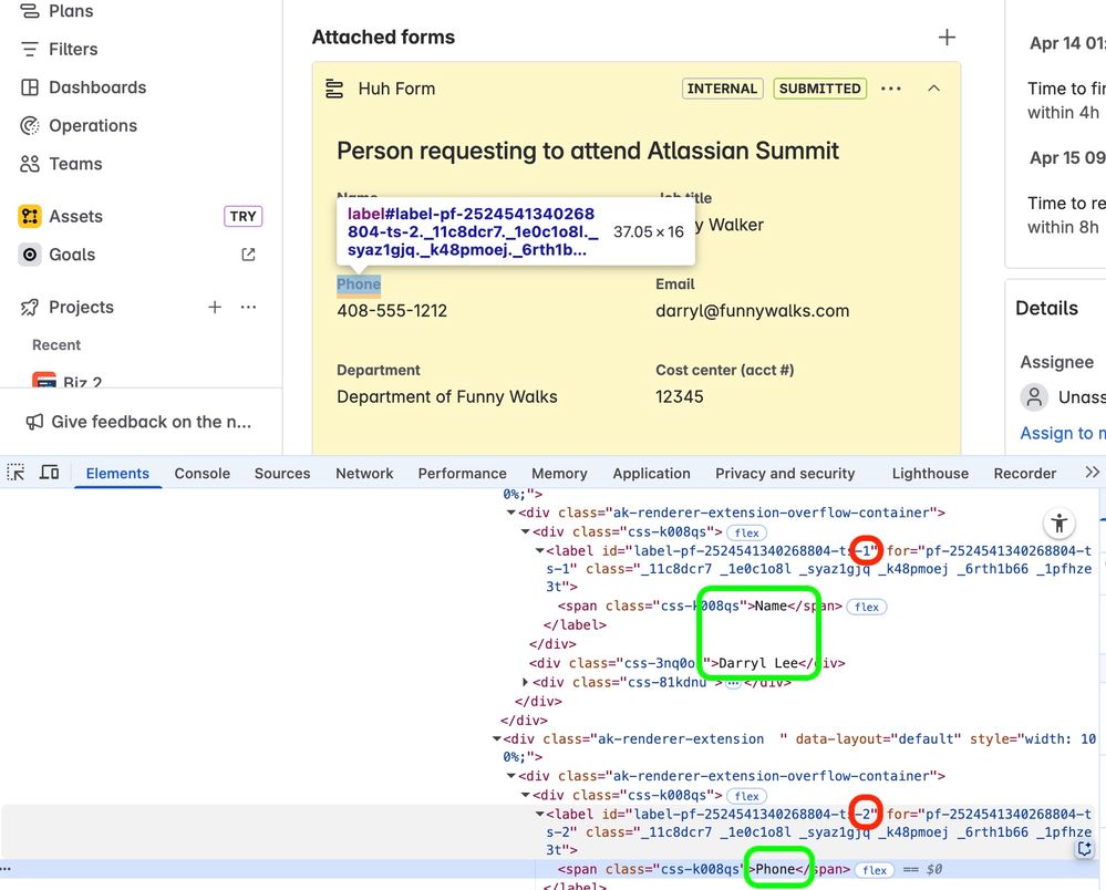

But here's a hack to get the Field IDs. If you use Developer Panel and inspect elements, the field ID is in the label for each field:
Or you could do what I did and sniff the network traffic when you update a form.

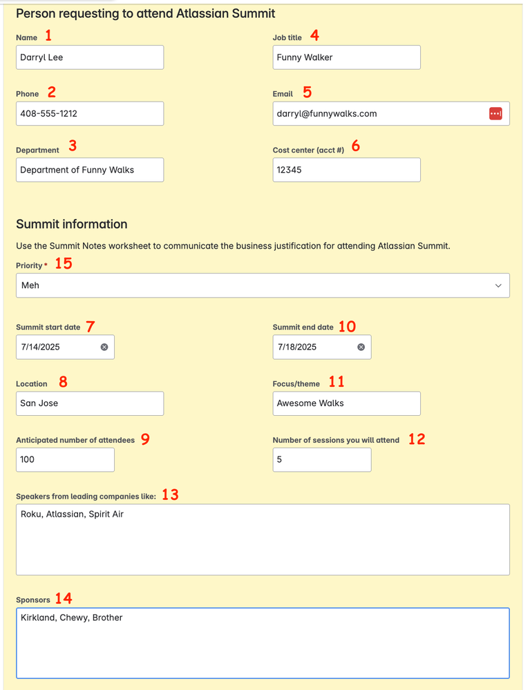

At any rate, I believe your payload should look something like this.
  "1": {
    "text": "0"
  "2": {
    "text": "0"
  "3": {
    "text": "test description"
  "4": {
    "text": ""
  "5": {
    {"choices":["0000000"]},
  "6": {
    "text": ""
  "7": {
    {"choices":["1"]},
  "8": {
    "text": ""
  "9": {
    "text": ""
  "10": {
    "text": ""
  "11": {
    {"choices":["2"]}
 The trick is getting the right IDs. For me, it mapped like so:

--header 'Content-Type: application/json' \
--data '@formdata.json
And here is my data file (formdata.json):
    "answers": {
        "1": {
            "text": "Test Lee"
        "2": {
            "text": "408-555-1212"
        "3": {
            "text": "Let's update this form"
        "4": {
            "text": "With new data"
        "5": {
            "text": "darryl@funnywalks.com"
        "6": {
            "text": "12345"
        "7": {
            "date": "2025-07-14"
        "8": {
            "text": "San Jose"
        "9": {
            "text": "100"
        "10": {
            "date": "2025-07-18"
        "11": {
            "text": "Awesome Walks"
        "12": {
            "text": "5"
        "13": {
            "text": "Roku, Atlassian, Spirit Air"
        "14": {
            "text": "Kirkland, Chewy, Brother"
        "15": {
            "text": "",
            "choices": [
                "1"
If you are still getting errors about malformed JSON, I suggest running your data through https://jsonlint.com/ - it helped me find an extra " character that had snuck in.
