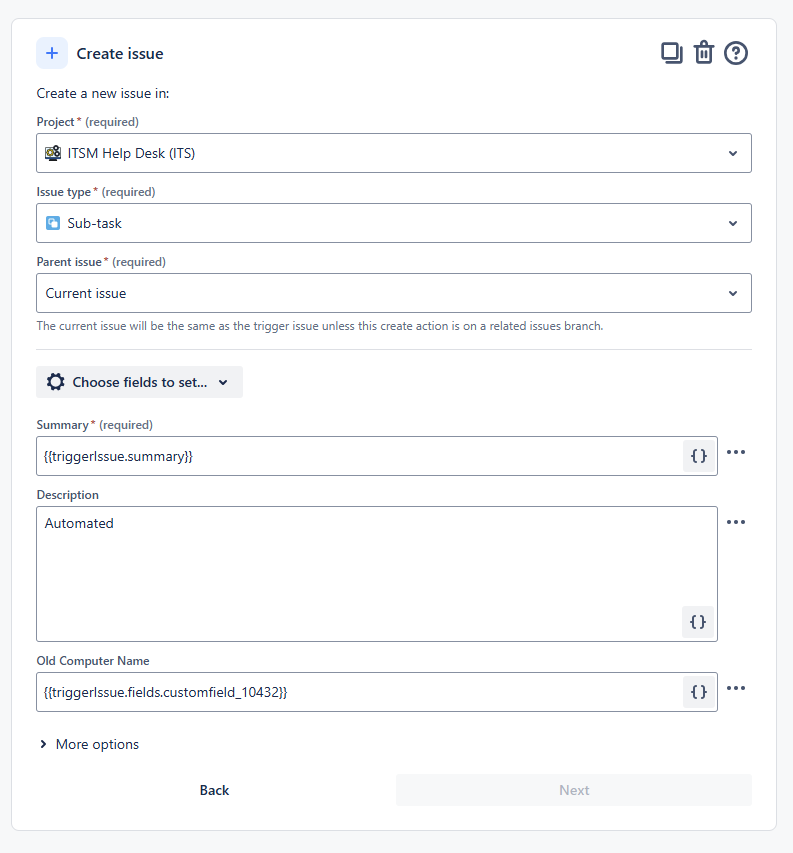

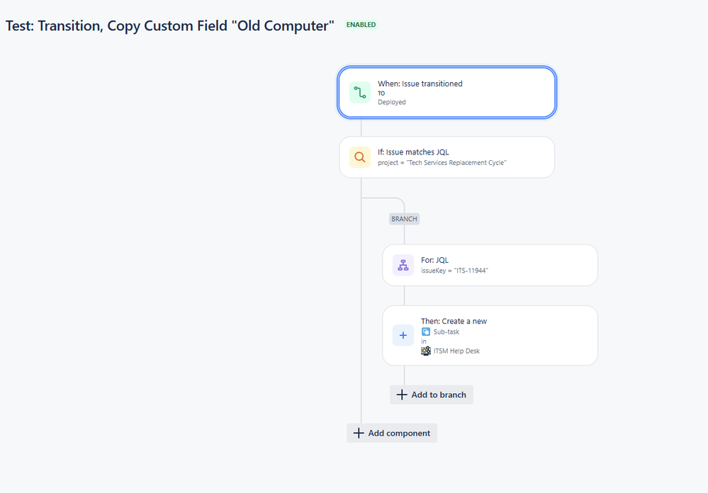

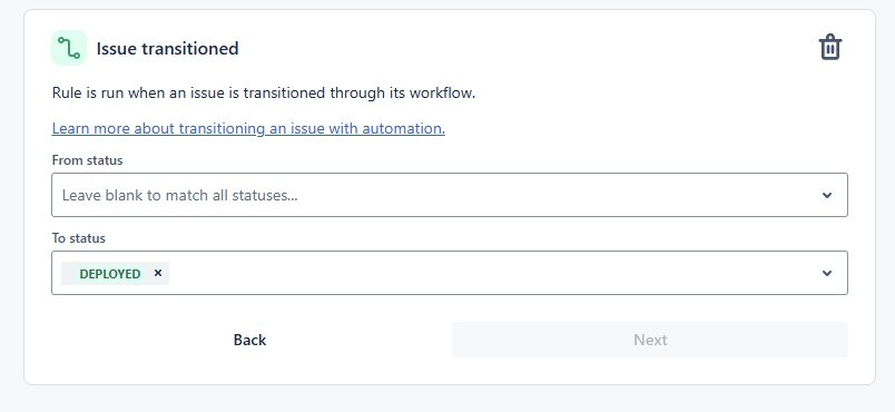

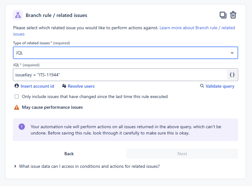

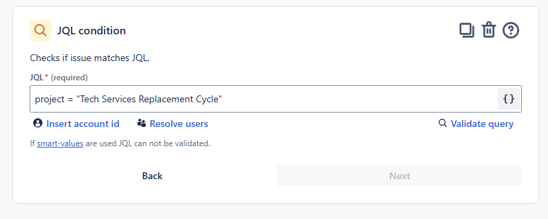

Currently, I have automation established:
1. Trigger: Transition of status in Project R
2. Create a sub-task on a particular ticket in Project H
3. Copy the custom field (currently named "Old Computer," Assets objects type) from the trigger issue (team-managed Jira project) to Project H issue (company, JSM).
Everything works as expected, except that the Old Computer Name (present in both issues) doesn't update.
If I can get the field information into the JSM project, then changing asset status is a breeze, but I'm running into a roadblock here and would like some help identifying what the particular issue is.

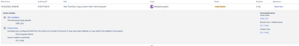

It will enable us to help you more effectively if you provide screen images that show the entire Automation Rule, the details of each step in the rule, and the results in the rule execution audit log.
Sometimes problems come from the context of a step. Sometimes problems come from typos. Sometimes problems come from choosing the wrong options. We can't determine that without seeing the rule.
And if there is any error message being produced and recorded in the log, we need to see that.
What is the result you observe in the JSM issue when this rule runs? Does the Object field in the JSM issue get updated?
