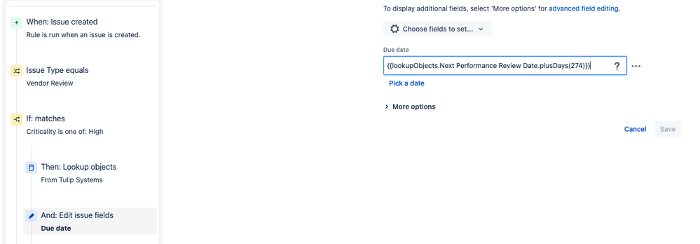

I am trying to update the "Due date" field within a created issue. The created issues are for the review of our Vendors. We have an object type called "Vendors" where all Vendors are stored. The created issue's "Due date" should be based off of the "Next Performance Review Date" attribute stored within each Vendor object. Screenshot 2023-05-04 at 11.10.58 AM.png
You can see below, the automation checks our defined criticality of the vendor and depending on the criticality and the next performance review date, the due date is determined. To me the smart value makes sense, but every-time I run the automation it completes successfully but the due date is not updated within the issue.Screenshot 2023-05-04 at 11.12.18 AM.png

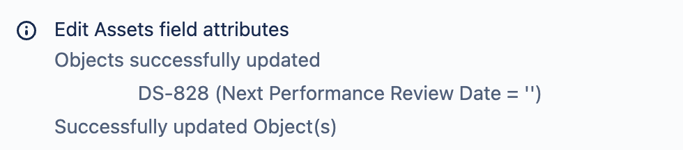

When I "Log Action" and use the following smart value {{lookupObjects.Next Performance Review Date}}, the correct value is populated. However, if I try to change the smart value to {{lookupObjects.Next Performance Review Date.plusDays(274)}}, the value is blank. The same result is reflected in the automation log:

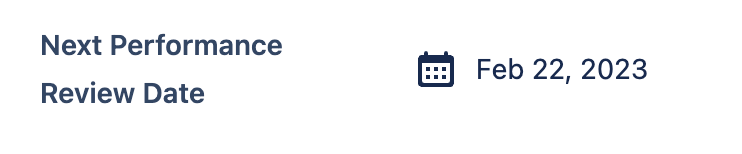

The problem is caused by the different date formats used by your asset object and Jira.
When you retrieve your "Next Performance Review Date" from your vendor object, the date format is 22/Feb/23. Unfortunately, this date format does not allow you to perform date calculations on it. That is why your automation rule fails.

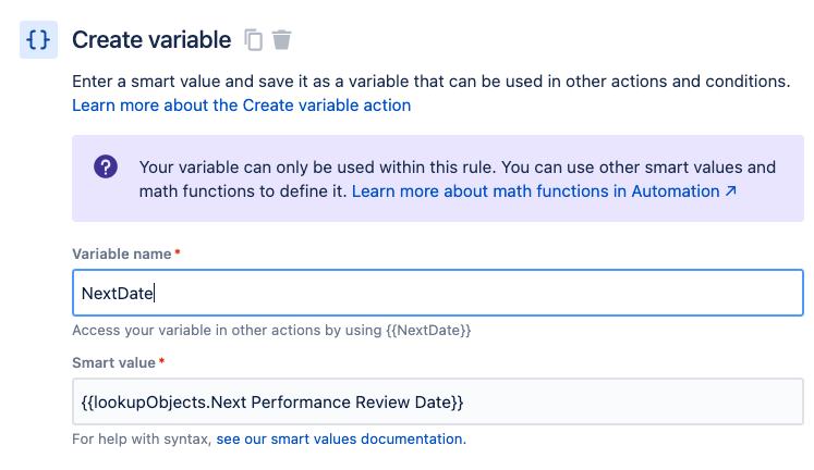

1. Put the object date into a Variable
2. Next, you can use the regex mentioned in the article to convert the variable date to a "2023-02-22" Jira date format. In the same step, you can add a number of days to this date and set this value as the due date. To do this, you add a 'Edit Issue' component to your workflow, and set 'Due Date' to this smart value
{{NextDate.match("((\d{2})\/(Jan|Feb|Mar|Apr|May|Jun|Jul|Aug|Sep|Oct|Nov|Dec)\/(\d{2}))$").toDate.plusDays(274)}}
