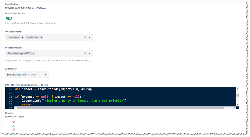

November 12, 2023
Where did you implement that script?
It should be in a Script Listener and associated with the "issue updated" and "Issue created" events.
Copying that script as in (nearly) the "code to run" section of the scriptrunner script listener worked like a charm.
THe only change I made to the script was adjust the field names and project key filter.
Zaldy Parian
November 12, 2023
Hi @PD Sheehan ,
I updated and pasted the code under the "If the following condition evaluates to true"
Cheers,
Zaldy Parian

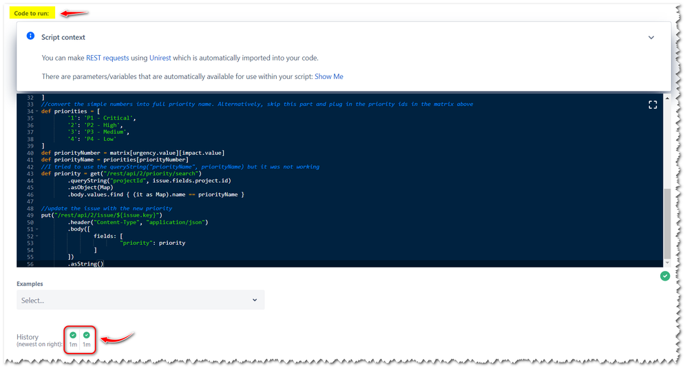

November 12, 2023
Hi again @PD Sheehan ,
I moved the script to "Code to run" space. And updated the Urgenct and Impact of an issue in my TEST project.
Although the priority remains unchanged, when I look at the script, I noticed there were green ticks (as opposed to red Xs earlier).  I guess we are going to the right direction. I just need to figure out why the priority did not change.

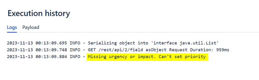

Zaldy Parian
November 12, 2023
And I checked the log. It says missing urgency or impact

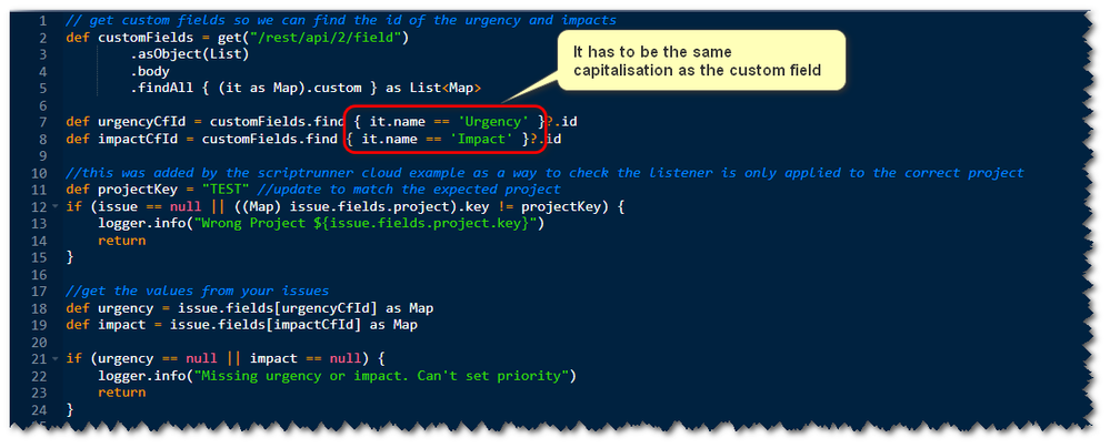

Did you make sure the fields name match with the correct case?
it my original example I had impact with lowercase i.
Zaldy Parian
November 12, 2023
Hi @PD Sheehan ,
I think I found the issue with the script. I have typed in the field name inaccurately. When I changed the field name to have capital letter at the start, then the auto setting of priority worked!
