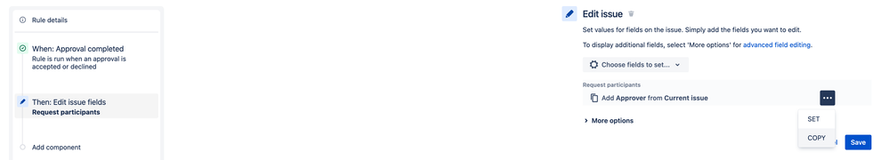

Tobias H
February 27, 2023
Hi David!
I believe this is possible without using JSON.
Set the automation to trigger
When: Approval completed
Then: Edit issue field
Screenshot 2023-02-27 at 13.11.23.pngSelect Request Participant from the cogwheel drop down
Press the three dots to the right of the field below the cogwheel and select Copy.
Change the value to copy from Appover and make sure the checkbox to "Add to existing values" is kept checked, that way it won't write over the existing request participants.
(Edit: Fixed the last image, as it said request participants earlier)
David Kintzinger
February 27, 2023
Thank you for your answer. I already implemented the solution that Rilwan Ahmed stated above but yours seems to do what we need as well.
