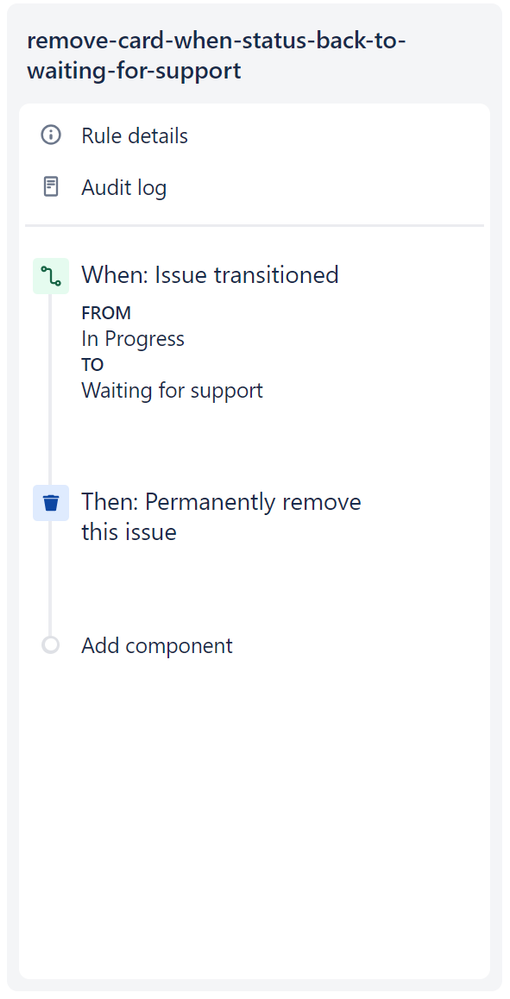

Dewa Fakha Shiva
July 26, 2023
Hi John,
This is the latest rule that I have.
It was a single project, and now it is multiple project.
But I still don't delete the issue correctly and delete the ticket instead.
John Funk
July 26, 2023
So, you need to add a Branch for Linked Issues between your two components of your rule. Then move the Delete issue action underneath the branch.
Give that a try and see if it works for you.
