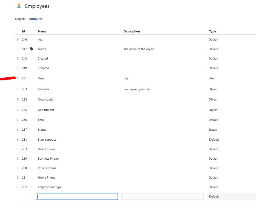

Hielko Manders October 25, 2023
Hi Marc,
As you can see I have an attribute of type user in my schema but when I use currentReporter(), which can be used in AQL the query still doesn't return any objects.
Regards,
Hielko
Marc - Devoteam
October 25, 2023
Hi @Hielko Manders
What is the value set to the attribute in the object?
To use current user, you have to specified in the object as the user.
