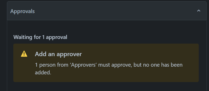

We are migrating our Help Desk into JIRA and I have run into an issue I cannot seem to figure out a solution to.  For example, when a Manager is selected in an Onboarding ticket and then the ticket is submitted, the tech team is unable to edit that selection.  The user is also unable to edit what they chose in that location.  This also happens in our Approval fields for Purchase Requests.  This also happens if the field is left blank, we are unable to edit it. I am hoping there is a setting or permission I just need to enable to do this.  I am attaching a few screenshots of the fields I am talking about in case I am explaining it poorly.  Included is an approval that we are unable to edit, yet the error says no one has been added.  Thank you for any help!Screenshot 2025-04-11 135129.pngScreenshot 2025-04-11 135219.png

3. “Approvers” field behaves differently
The default Approvers field has special behavior:
  • It can only be edited by Project Admins, or
  • Users with permission to Manage Approvers, or
  • Through automation rules
If the field is empty at transition, Jira may require it — but won't allow editing unless it’s visible on the screen for that transition or edit.

Jeren Wunder
April 14, 2025
I appreciate your info... but I am totally lost.  I am brand new to JIRA and trying to even find the stuff you listed has been difficult.  Let me try to relay my first issue here.
I can get as far as the Request Form but then I have no idea where the "Edit Screen" is.  I am not sure how to do that.
Jeren Wunder
April 14, 2025
@Raphael Lopes Thank you.  I was able to figure out how the screens worked and got them added to the correct spot.  It now works!  I appreciate your help!
