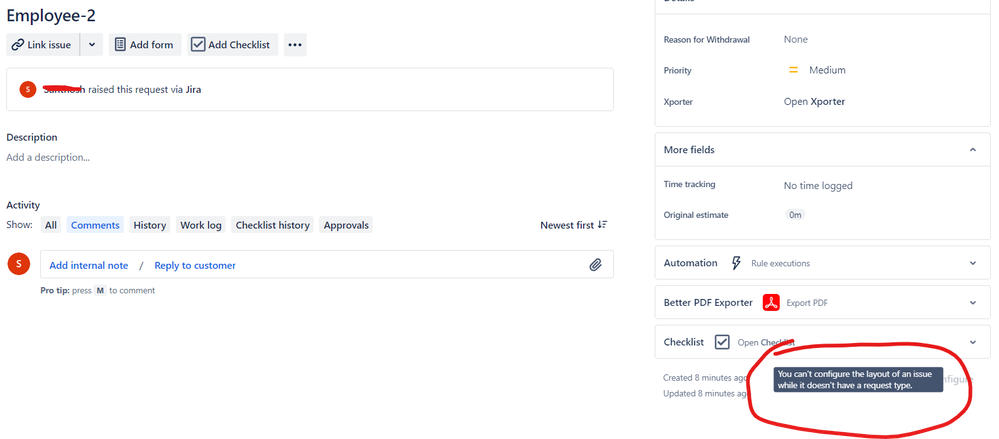

But I have a parent issue type connected with request type for portal forms.
So is it the same.
For Example:
Issue Type: SQL
Request type : SQL
So connected both Issue type & request type.
I'm not able to process this.
Could you please help in processing this in any other ways ?

First you should understand the difference between Request Types and Issue Types. Requests are what is shown to customers in the portal. Also, the Agent view (Issue view) is configured per Request type.
Every Request type is connected to an Issue Type. An Issue Type has Screens and Workflows. So the Issue View will usually be determined by Screen Configurations and are connected to the Issue Type. In Jira Servicemanagement, you can overwrite these Screen Configs for each Request Type.
Requests are configured per JSM Project in the Project Administration. Screens are configured centrally in Jira Administration.
The button you want to click directs you to the Request configuration and only works, if you are currently viewing a Request. In your case, you created an issue in a JSM project without choosing a Request type. That's why you are getting an error message.
A JSM Issue without Request is not shown in the customer portal.
@John Funk is correct with the Sub-Task Issue Type. Requests cannot be configured for Sub-Tasks. You can have Sub-Tasks under a Request but they will not be shown in the portal and you always need a parent that is connected to the Request type.

@Santhosh Raj wrong.
A Request Type has an issue view that overwrites the underlying issue type's Screen. -> JSM Project Config
You can create Sub-Tasks for the Issue Type (just like in a normal Jira project) and you can configure Screens to be specific/different for Sub-Tasks. -> central Jira Administration.
Sub-Tasks are invisible to customers and cannot be connected to Request Types.

I don't understand where the problem is. I create Sub-Tasks from within an existing "normal" Task (or Request). No issues there. I am not asked for a Request Type.
You cannot "Configure" the screen from the Sub-Task View directly - if you refer to the small gear icon on the bottom. That is for Request Types only. You will have to go into Jira Administration and change the Screen for the Sub-Task there.
