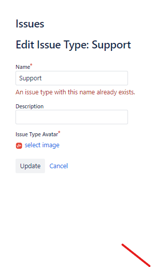

Ayush Lawania
December 21, 2023
Screenshot 2023-12-21 190837.pngI tried changing the avatar only, but still I get this error. @Evgenii
Evgenii
December 21, 2023
You tried to change icon only?
Or you also tried to change issue type name?
Ayush Lawania
December 21, 2023
Just the icon
Ayush Lawania
December 21, 2023
@Evgenii I just tried to change the icon, I have done this thing before but not sure why i am getting error now
Evgenii
December 21, 2023
I think, that it's worth to do next steps:
- Check, that there is only one issue type with name Support
- As a workaround, I'd try to change name of faulty issuetype to something like Support123, and change icon. If everything will be ok, then change name back to Support (of course if there are no duplicates)
If there will be the same error, even when name is changed to something unique, it's worth to write to support.
