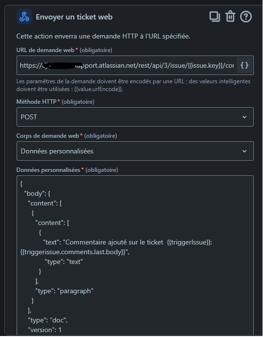

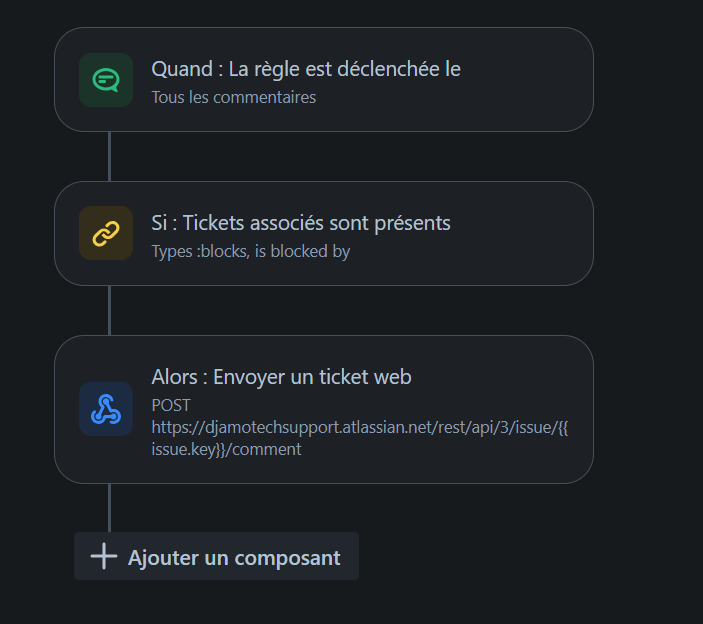

1 - My automation on js
2 - In send web request, i put this
Webhook URL* : https://jsm.atlassian.net/rest/api/3/issue/{{issue.key}}/comment
HTTP Method : POST
Webhook body : Custom data
Custom data :
"body": { "content": [ { "content": [ { "text": "Commentaire ajouté sur le ticket : {{triggerIssue}}", "text": " Dernier commentaire : {{triggerissue.comments.last.body}}", "type": "text" } ], "type": "paragraph" } ], "type": "doc", "version": 1 }
Headers : Key : Authorization / Value : Basic API_TOKEN (generated in jsm)

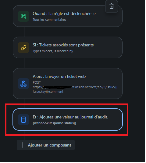

So i add {webhookResponse.status}}
But, I don’t see any change in the logs

Jehan Bhathena
September 9, 2024
Add this syntax {{webResponse.status}} and retry the execution.

Can u share a snapshot of your web request action?
Davy Evrard YORO
September 9, 2024

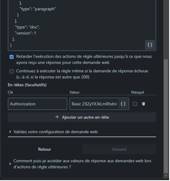

I would suggest making 2 changes
Firstly, check the second box as well so that the flow proceeds even without 200 response, this is for testing sake, and can be unchecked once you're confident the automation works fine.
Next I would Try using the Validate option, with one  of the issue keys whose comment you're trying to copy. This will give you instant feedback if something is going wrong.

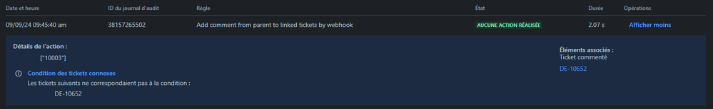

Also, are you creating a new issue in the same automation? If yes, then you'll need to add the refetch issue data Action to get the new ticket details.
