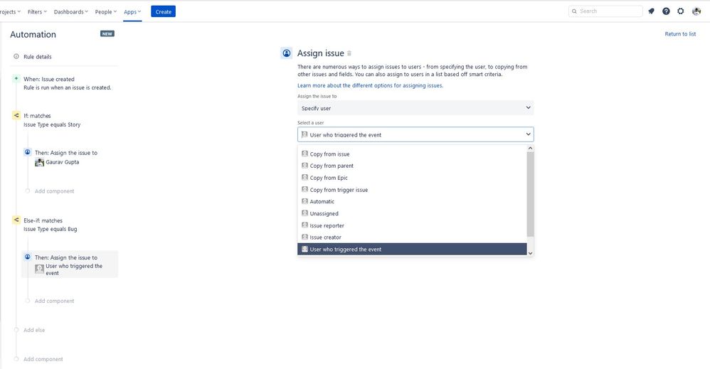

Hello @Jack Howard
Welcome to the Atlassian community!!
This is achievable using automation. From the Project Settings navigate to Automation and create a new rule. Please refer to the below screenshot for the detailed set-up of the rule. This can be extended or customized as per your requirements.
Please accept the answer if this helps solve your query else respond and allow others to share input.

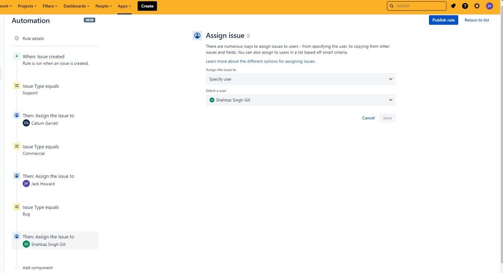

Jack Howard
August 4, 2021
Thanks @Gaurav, I found that condition.
I do however notice that it doesn't indent like yours does, and branch off for each if condition. Does this look right to you?
Jack Howard
August 4, 2021
I have just found out why! I need to use an 'If matches' instead of 'issue type equals'

Gaurav
August 4, 2021
Hello @Jack Howard
There is an indentation in the automation created by me as I am using the 'If-Else' statements while you are directly checking the Issue Type.
Logically, both will work in the same manner but as you are not using the 'If-Else' construct, it will check for each condition which might take a little bit longer...not that you will notice. But as a good practice, I would suggest using the 'If-Else' construct.
