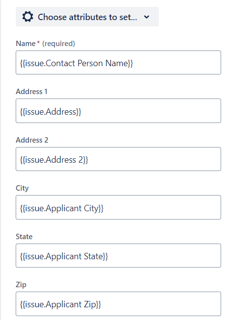

Here is a partial screen shot. I am using the "Create Object" action to create an Assets object.
If one of these fields from the issue is empty, A4J throws an error message. The object is created correctly and the rule continues on. However, I get a failure email notification. I tried using an {{if}} conditional, but that raises the same problem.
The root problem appears to be that the smart value returns an empty string instead of a null and that confuses the rest call when it tries to update the value.
