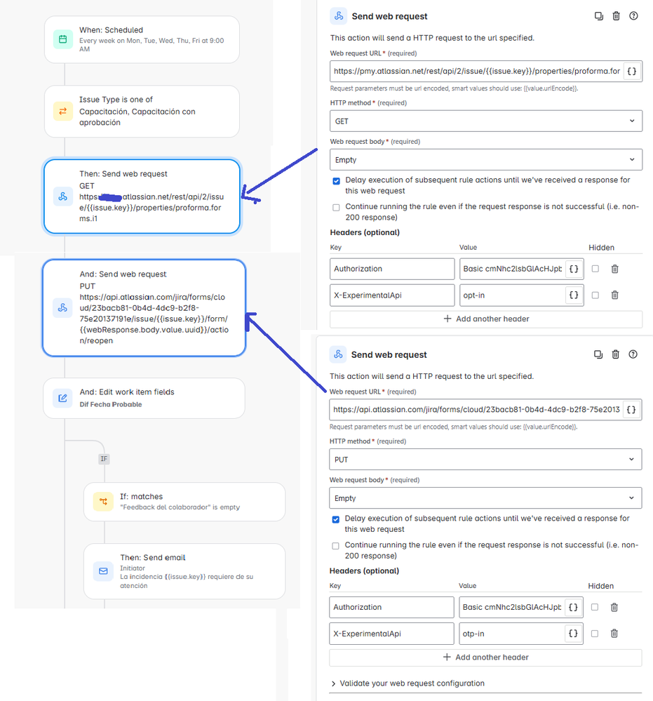

Some months ago (March to be exactly) I have created an automation that reopens a form when certain condition is met.

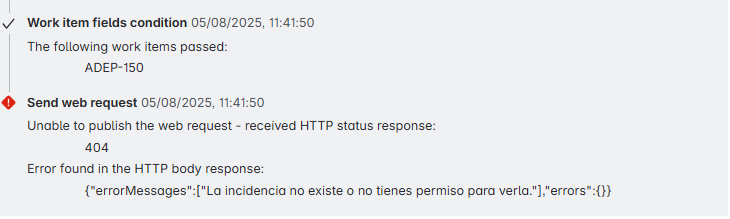

It worked since then until today that it failed with this error:
I do not know which is the problem the actor of this rule is correct and has the permissions
here the screenshots of my rule
I double check the apitoken to be enabled and that it is encoded (email:apitoken)
but still getting this error that, again, it was working til today.

What is you replace /properties/proforma.forms.i1
with: properties=proforma.forms.i1
Also change the API version to valuee 3 or latest.
Does this get you a result, I het result in calling this in postman.

I think the Proforma API endpoints are going away and that is why you are getting the 404 error. I haven't seen an announcement about it yet, but recently there were an action added to automations for changing form status that you can now use to set the status.
