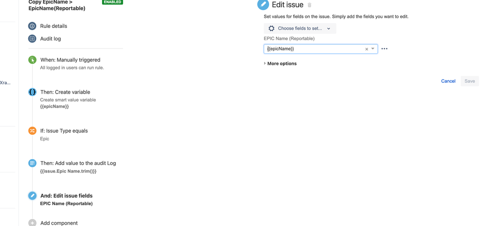

This will set a select list value based on another onn edit.. I'm now on looking on how to create a new option..
This works on the Current Epic

Thanks for that @Darren Pegg  - I'm afraid that does not work :(
I want to edit it with JSON and then use it as a variable as you have started with ...
I cannot use the field, as you have for EPIC Name (reportable) as you have as it is an custom app field and not a custom field created on Jira itself.
