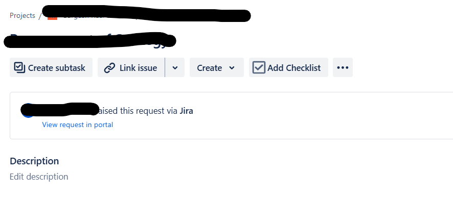

I understand that.  Sorry I wasn't specific enough.  I am trying to use the create button in a parent issue.  (See screenshot above).  The "Create Subtask" option isn't there.

@John Funk You are correct it can't be done with the create button.  However in a different service desk I do have access to a separate create subtask buttonGyro.png

Can you share a full screen shot of that?

I don't mean to ignore them I had thought you could create them with the create button in a parent issue along with the "Create Subtask" button, until you pointed out otherwise.  I do not see the "Create Subtask" button in any tickets in one of my service desks but I do see the "Create Subtask" button in tickets in a different service desk, so I still assume there must be a setting I can change to get it to appear.
John Funk
March 14, 2025
The Subtask issue type is probably missing from the Issue Type Scheme for the project where it does not show up.
