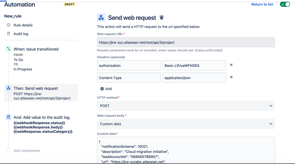

I am trying to automate Project creation from an Automation Rule.
The GET REST API returns 200 response code, however, the "POST" API is returning 500
what am I missing?
http method POST - https://jira-xyz.atlassian.net/rest/api/3/project
Headers-
authorization: Basic setsdkjfkjhdxtjydfgl
Content-Type : application/json
custom data -
"notificationScheme": 10021,
"description": "Cloud migration initiative",
"leadAccountId": "569565786957",
"url": "https://jira-xyzabc.atlassian.net",
"avatarId": 10200,
"issueSecurityScheme": 10001,
"projectTemplateKey": "com.atlassian.jira-core-project-templates:jira-core-simplified-process-control",
"name": "Example",
"permissionScheme": 10011,
"assigneeType": "PROJECT_LEAD",
"projectTypeKey": "business",
"key": "EX",
"categoryId": 10120

On the post method you use this URL https://jira-xyz.atlassian.net/rest/api/3/project, but inside your date you use this one https://jira-xyzabc.atlassian.net
Could that possibly be the problem?

I get the same 500 response as well while using " https://jira-xyz.atlassian.net"  inside the data

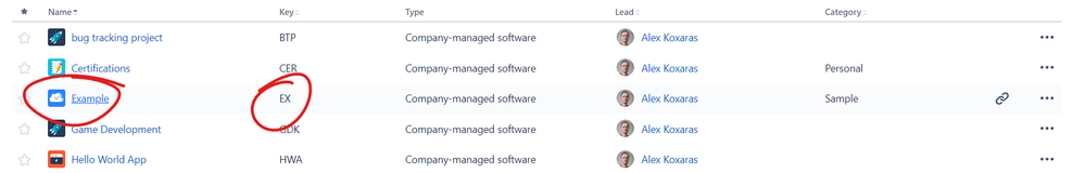

I've successfully managed to create a project via REST API, using the following code, which is suitable for me:
"notificationScheme": 10000,
"url": "https://koxaras.atlassian.net",
"avatarId": 10200,
"issueSecurityScheme": 10000,
"leadAccountId": "5f9fb7c1c2e5390077abf628",
"projectTemplateKey": "com.pyxis.greenhopper.jira:gh-simplified-basic",
"name": "Example",
"permissionScheme": 10000,
"projectTypeKey": "software",
"key": "EX",
"categoryId": 10000
  • First and foremost, you have to make sure that the URL is the same both in your data, as well as on the webhook
  • Then you have to go ONE-BY-ONE and make sure that ALL IDs are valid for your instance
    • notification scheme
    • issue security scheme
    • persmission
    • category id
  • Then you have to add the correct LEAD id
In the example below, I change the project type to that of a kanban.

Copied the above, changed the lead id (my account), URL(same for webhook and data), and used "10011" permission scheme

On the basic authorization, did you embed as well your email address with the api token you created?
surya manne
October 18, 2021
Yes, basic authorization with email address and API Token (Base64 encoded)
