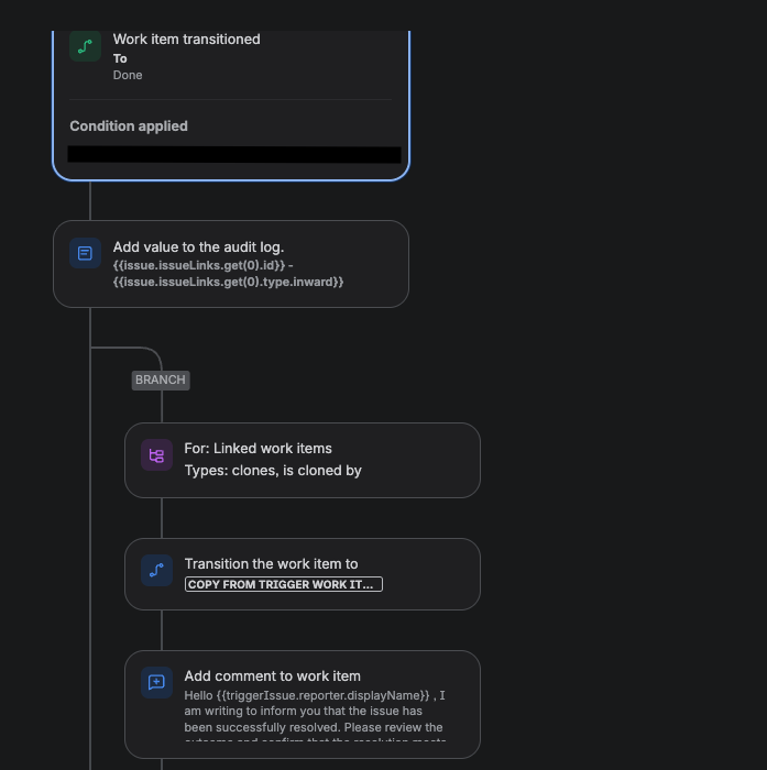

I need to implement a status transition across two projects/spaces (Jira portal and JSM): when a ticket in the Jira portal is moved to Done, any linked work items (linked via “is cloned by”) should automatically transition to Resolved in JSM.

What have you tried so far? Have you looked at doing this via an automation? It should be pretty straight forward, just trigger on the transition to Done and then transition linked items to Resolved in the other project. You would need to set the scope of the flow to be multiple spaces, meaning that you need Jira admin permission in order to create the flow. There are example flows in the template library that can get you started, just look for Manage completed tasks.

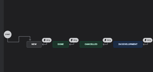

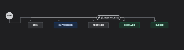

For: Linked work Items I have both spaces.
Jira project

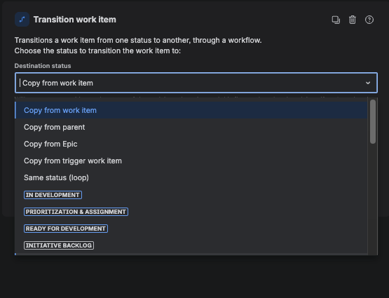

Transition work item to: I don't have Resolved status, I believe this is the problem.

What is the scope of your automation? If both projects are in scope then you can start typing in the status you want the linked work item should transition to and it should show up in the transition step.

Thank you for the tutorial which will work perfectly if I have the same status on JSM and Jira.
The error is because Open does not exist in Jira and New does not exist in JSM and I didn't find an way to make this work
